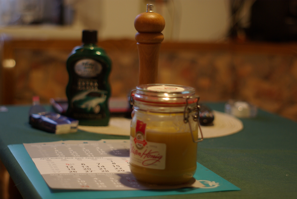

Ok.. I know I'm not very fast but here is a little test.
All shots were taken on a tripod. Focus point was the honey jar.
Lens was the genuine K-mount manual focus SMC Pentax 1:1.8/55
First shot was focused with measuring tape - tack sharp
Second shot was focused with my eye - back focus shift.
Third shot focused via af aid - back focus shift
