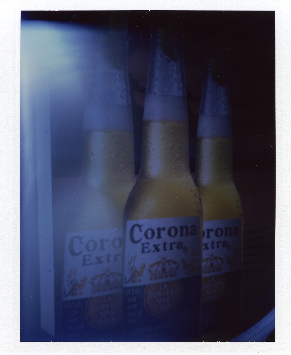

I have recently started to dable in pinhole photography. Here are a few of my shots that I would like to share.
https://fbcdn-sphotos-a.akamaihd.net/hphotos-ak-ash3/7948_4106758917178_898901716_n.jpg

what format? film?
Looks like a very large hole for the format and focal length -- lots of blurring, little detail. Did you make the hole yourself? And is that lack of detail the effect you were going for? A more "optimal" size can significantly increase the amount of detail, but not everyone wants "optimal" or detail of course. 🙂

I bought a holga pinhole lens for fitted for canon dslrs, mounted it on my 40d. The hole looks very minimal, I was wanting more detail, perhaps I should have made one myself?
I replaced the default 0,3mm pinhole on my Holga PWC to a one with 0,23mm diameter. I think my shots are a little bit clearer and maybe even sharper but still retain the pinhole look.
