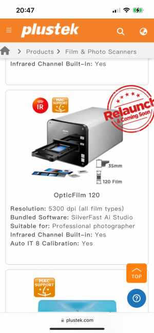

I just saw this on the Plustek site... does anyone knows something?
I don't think it was ever released. B&H's website lists it as "No Longer Available" and the newest review of it there was written in 2018.
