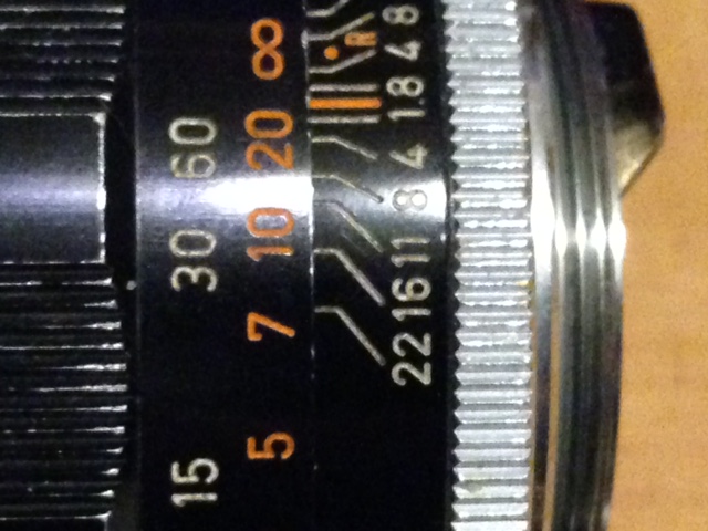

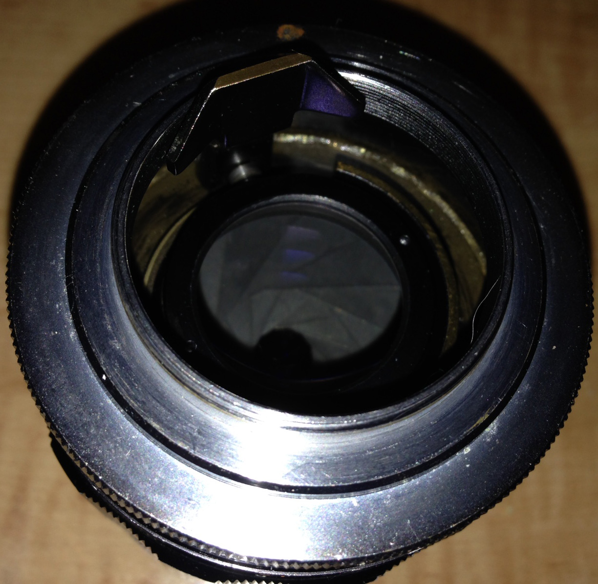

Here's a rear view of the lens-with the focus turned as far as it will go towards infinity-- looks like the roller does not come all the way to the infinity stop? If I'm looking at it right. Not sure about disassembly!

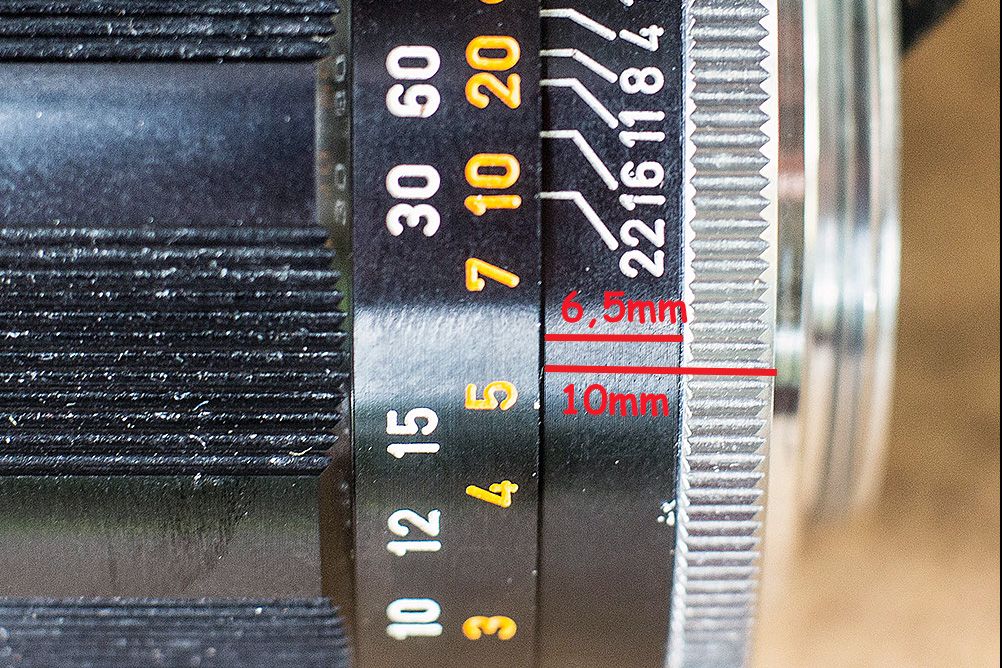

from this photo it is difficult to judge, but I would think that it does go as far as it should. Look at mine, at infinity, as indicated by the red lines, the distance of the ring with the distance markings to the silver ring is 6,5mm, all the way to the mount 10mm:
If your's does go that far too, I'd day chances are, as had been the case with my copy, that inner lens elements had been reassembled wrongly. If you want to ceck, here first how to look into the rear lens block:

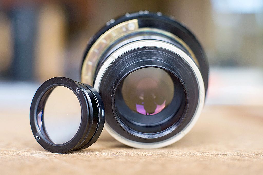

Canon LTM tele lenses can be screwed apart in the middle, it leaves the complete optical black separated from the focus helicoid:

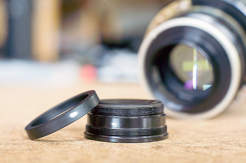

the rear side of the optical block will look like this:
see the two notches, that's where your lens spanner should go, or any other tools that you find to counterclockwise screw off the rear optical block
once this is done it's 'cap' can be unscrewed ( should do just by hand )
if you go that far just be careful, the two lenses inside this block, if turned upside down, will fall out ( do this over a soft surface )
and if you get that far, check if the two lens elements are assembled as shown at the lens diagram in the site of 'Taunusreiter' that I had linked in my last post, here it is again: http://www.taunusreiter.de/Cameras/Canon_RF_2.html#CANON_RF_1.8-85mm
The thinner lens goes in first with the flatter side down, than come a spacer tube that is cut out on one side, that side goes in first and holds that first lens tight, then comes the thicker element with the convex side first, the concave part up.

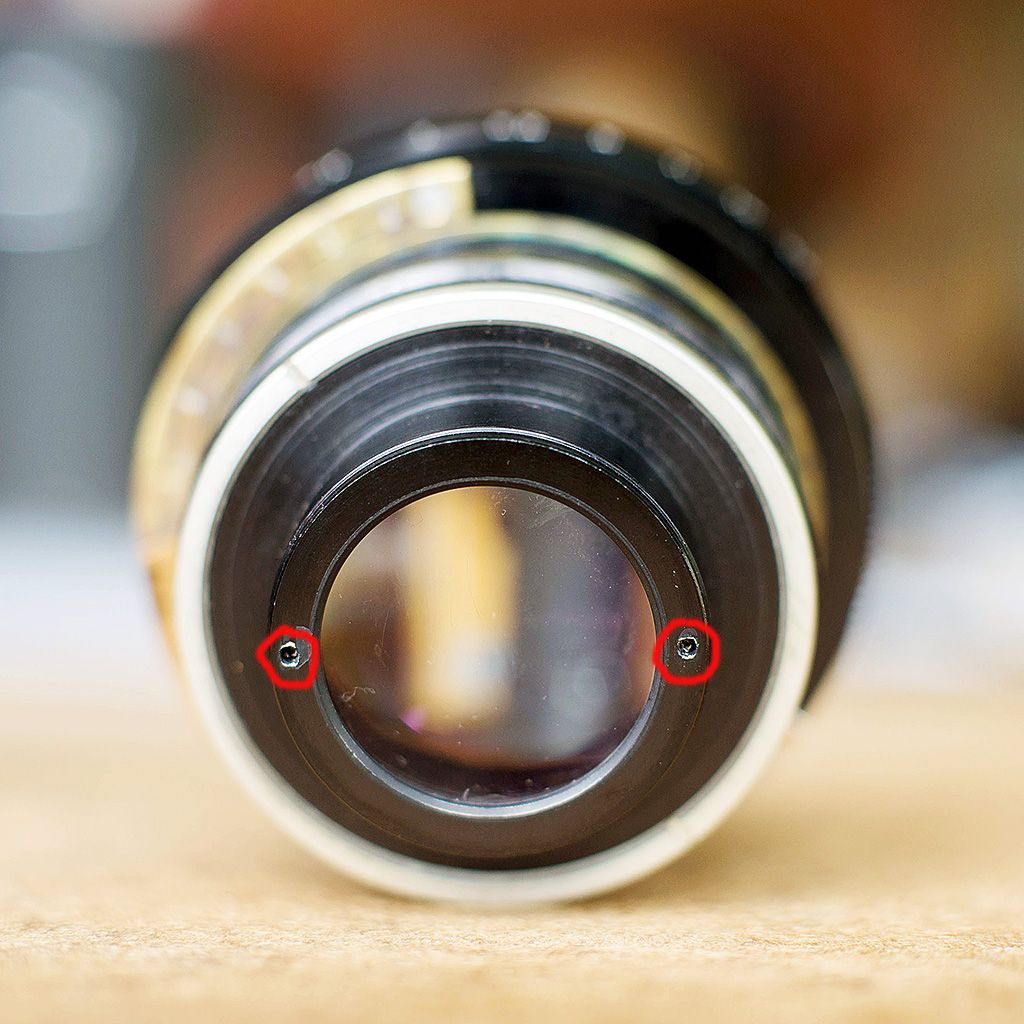

If that doesn't solve the problem next I'd look into the front block, the name ring has two grooves for a lens spanner.
