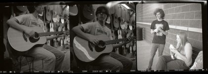

Attached is a scan from a test roll where you can clearly see the light leaks.
doesn't look like it is the bellows though...somewhere else (i.e.film chamber) or in the handling of the film.
should give the camera a check in the dark like i mentioned earlier, before sending it off
was it on every frame or just these few? and where on the roll, beginning, end or middle?
may need to get more creative and place a small lamp inside the closed camera to test for a leak in the camera back...odds are its in the handling of the film but hard to tell without more info
Was throughout the entire roll. I really wish I could check the camera right now for the leak, but it sorta has film in it at the moment...
Although, now that you point it out, I am nearly sure at the moment that it was due to handling the film because my other test roll did not suffer anywhere near as badly as the one I scanned and attached above.
