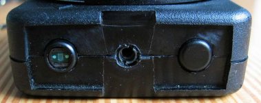

Maybe this will be interested to someone one day soon...
Recently I bought praised and very hard to find light meter Quantum Calcu-Light XP light meter. When I tried it out on a sunny day (and in lower lightning conditions later on), it seemed suspicious to me. I suspected it reeds too low. So I borrowed good working meter from my pro friend and it prooved that I was right. It read around 1 f-stop lower than it should. At first, I thought it needs re-calibration, so I contacted QLM, but they weren't eager to take it in and reccommended me to send it to Quantum. Quantum said that they stopped servicing them last year.
After some more thinking and looking at the meter, photo diode looked fishy to me. Quantum's support confirmed that it's corroded but didn't want to provide data about it, so I was on my own... Luckily photo diode search returned only few results and the first one looked exactly like the one I need. I checked the rest, but this is the only one that matches by size and description:
SHARP BS100C
http://www.datasheetcatalog.org/datasheets/90/123290_DS.pdf
This one is out of production, but there is lead free replacement BS100C0F available. Still very rare, though. Only place that I managed to find that stock them is Digi-Key:
http://search.digikey.com/scripts/DkSearch/dksus.dll?Detail?name=425-2447-5-ND
Digi-Key techs confirmed that these replacement diodes function in exactly the same way as original, so I decided to pay pricey shipping fee (at least I got the meter cheap - only $30!) and see if I'm lucky.
Anyway, I replaced diode and metering now coincides to borrowed meter and is very precise. Replacement itself is two minutes solder - resolder operation.
Check Before and After pics to see if your Calcu-Light XP qualifies for diode change...
