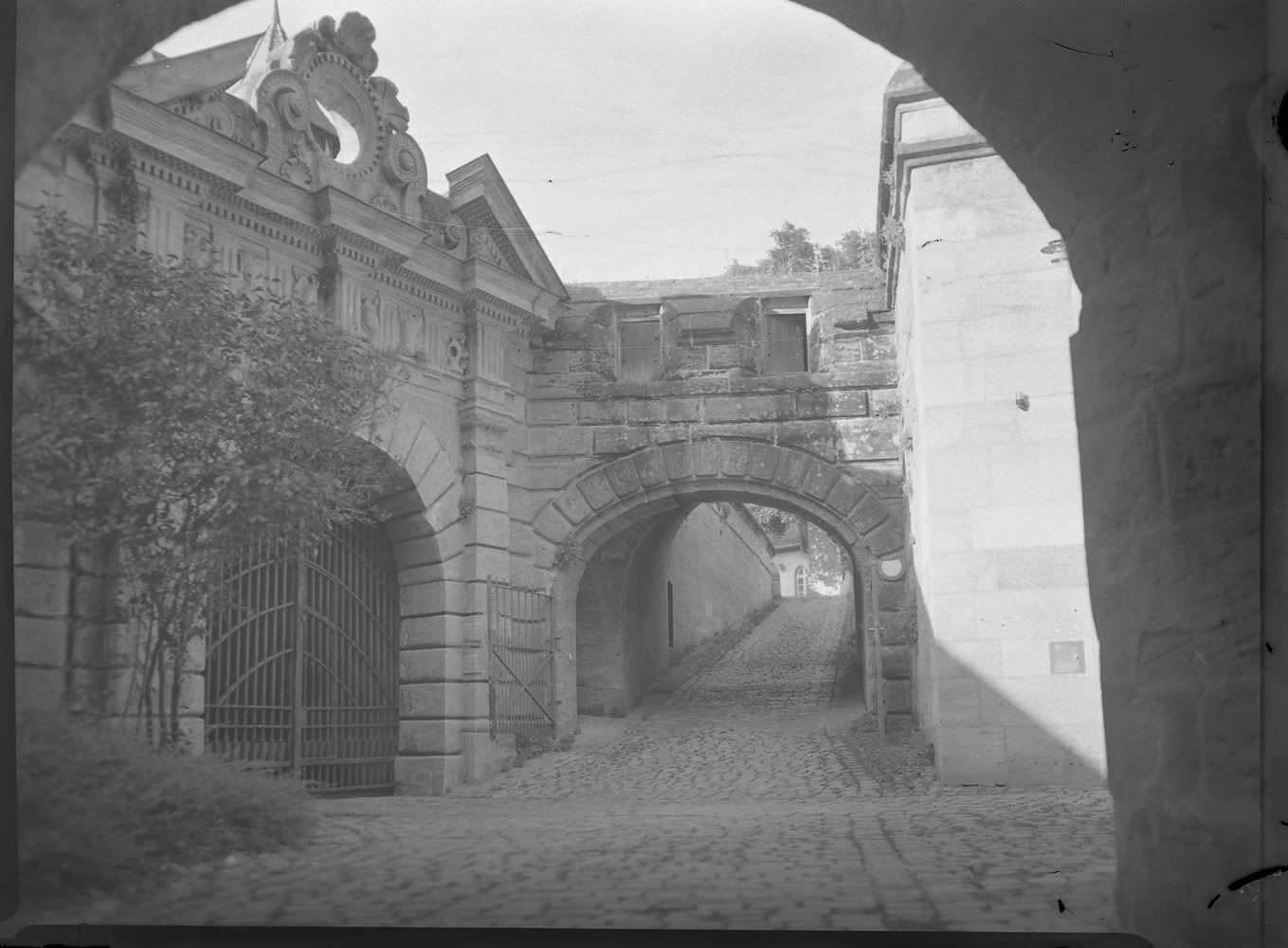

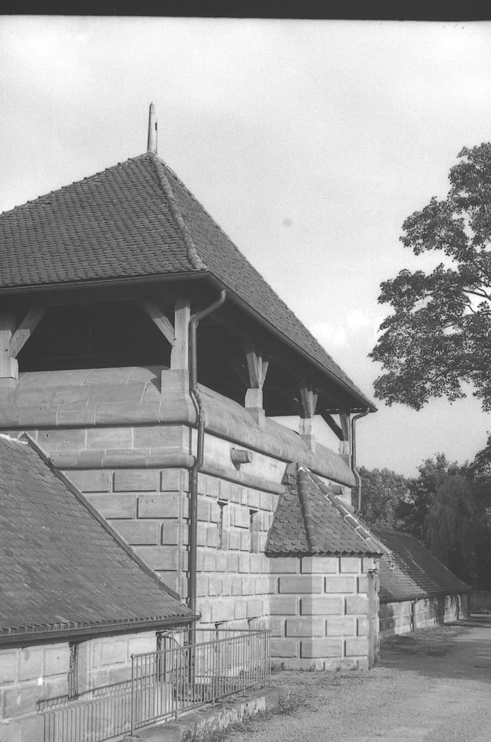

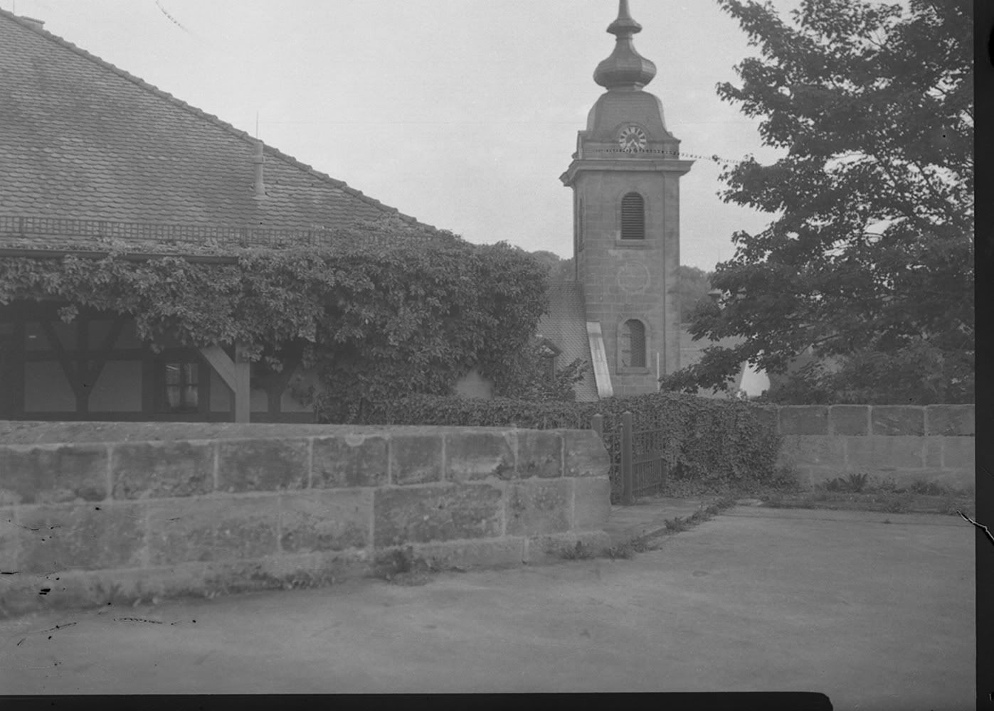

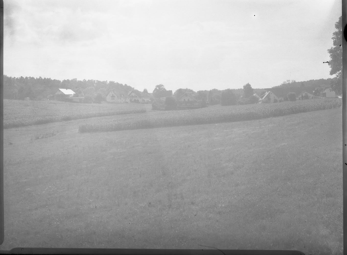

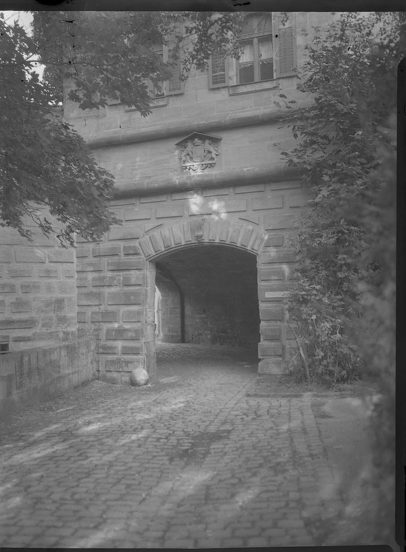

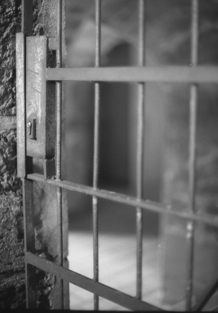

The scans. All images are just as scanned. I did no editing what-so-ever. All the scratches and peeling and such is due to my inexperience with developing. I will get better. The ones not labeled 3x4, where shot with my Leica M3 and 50mm F1.1 Voigtlander Nokton.
Shot with the 3x4 Speed Graphic, Efke 100 ISO
Shot with the Leica M3, Rollei Pan 25 ISO

Shot with the Leica M3, Rollei Pan 25 ISO @ F1.1 and 1 second.
