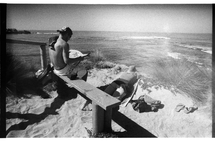

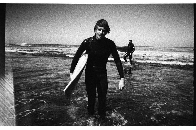

I'd never heard anything like this, but my Bessa R leaks light. It leaks enough that it has ruined some photos, and I can't figure out where the leak is (the seals are all good). I'd put it down to it being pretty beaten and it's not worth fixing now. Replacing it with a Leica very soon.
Here's how it looks over two frames, in the first frame you can see it around the bush; it's streaky and washed out looking, in the second it's more obvious the vertical line that cuts off makes me think the film is affected at the side it comes out of the cassette, and with the photos affected more strongly at the bottom the leak would seem to be toward the top of the camera:
