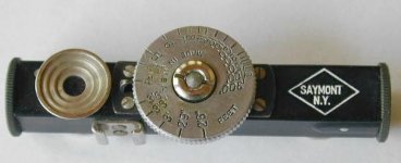

Hey guys thanks for the advice!! I did find some of the finders on the bay as suggested by a number of members. I bought one which I hope will work as well as it looks. For the price it was worth the risk.
Thanks again.
Ray

Oh oh! You're missing a part. See the hole between the eyepiece and the dial? A screw-in-type plug is supposed to go there.
