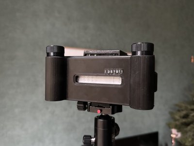

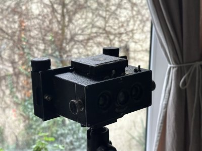

Im working on something nice that could be interesting for owners of a Heidoscop with Plate film back or without back or a roll film back thats old and leaks. A 3d printed roll film back. The back has a complex geometry trapping the light in every corner, a perspex plate at the back that allows continuous vision on the frame numbers, a pressure plate that is also light trapped with a maze like construction. Im testing the prototypes and will hopefully show you the first results very soon!
The design is finished ! Perfectly working no light leaks, added the registration to make 6 stereo views on one 120 roll instead of five. The only thing i want to change is to add a laser cutted plate with engraved frame numbers to the housing case and reprint that with an indent for leather finish.
The 3d files to print this version 2.5 can be found here:

Looks great - you mentioned that you’ll have detailed instructions added soon. When do you think you might have them added?
Dear Vincent, I was busy with other projects for the last weeks but will definitely catch up with this soon. Im planning to make a second version for the back cover that is finished with the same type of leather as the original heidoscop camera. Once those parts will have arrived I will finish the project up and create one full assembly tutorial and post it on youtube… so to be continued soon!
