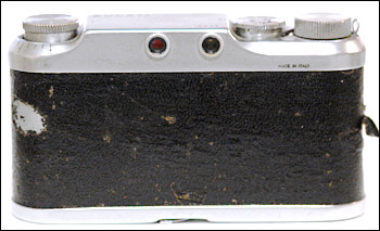

Here's a camera that was beyond saving. So I applied a new covering:
Before:
After
Before:
After
Nice work! you can have the front plate rechromed
