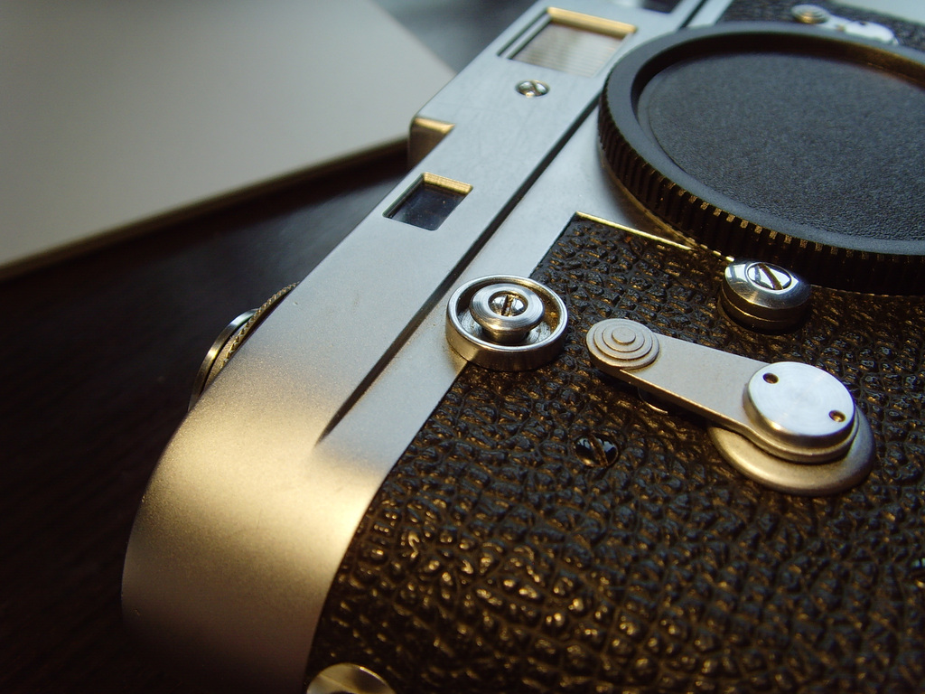

This is the normal position ... the outer ring is spring loaded against the body and if pressed the button clicks in and allows the film to be rewound
SNV33804 par Sparrow ... Stewart Mcbride, on ipernity

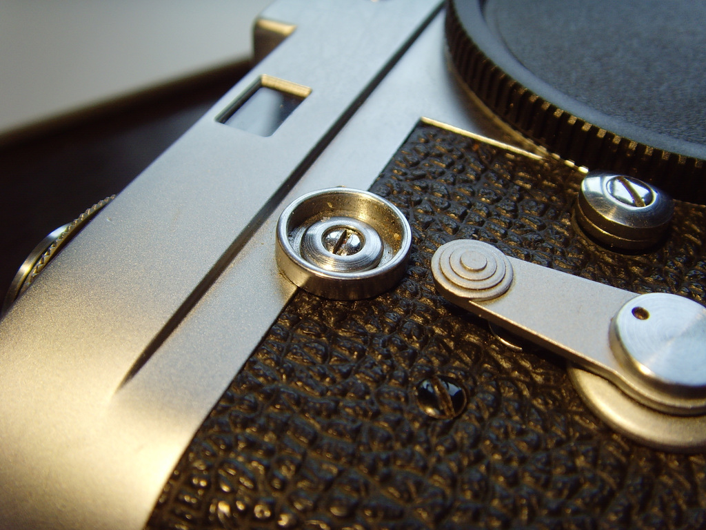

... at rest the outer ring can be lifted maybe a millimetre against the spring which normally keeps it against the body
SNV33809 par Sparrow ... Stewart Mcbride, on ipernity

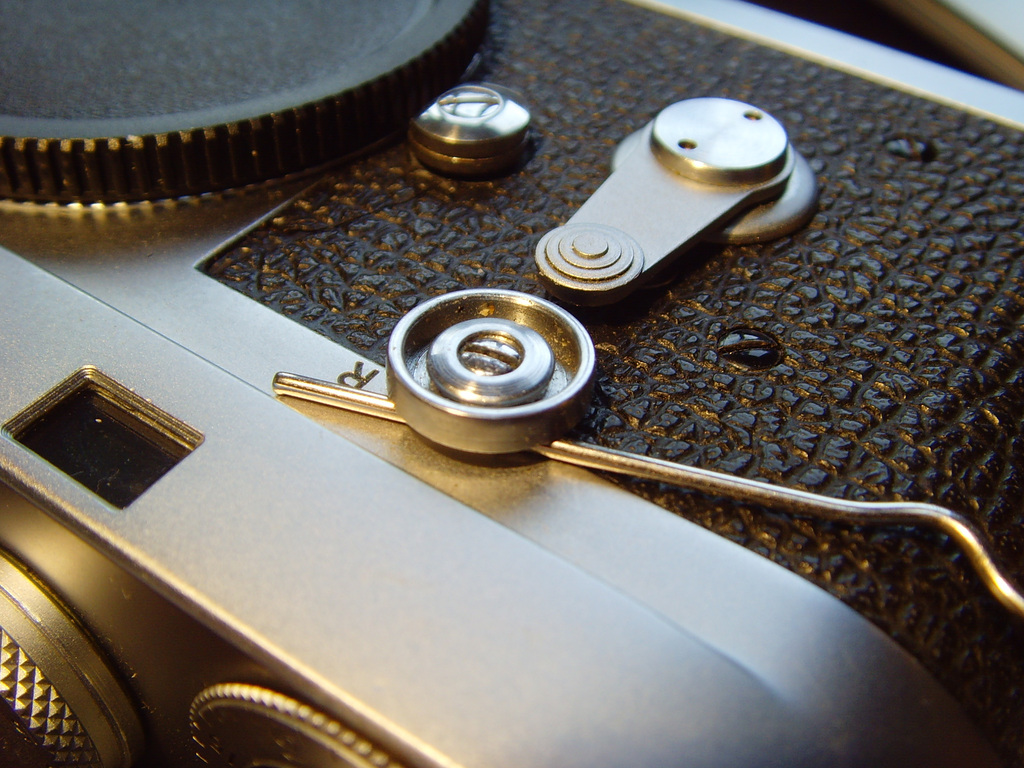

To secure the screw on mine I put some rubber under the outer ring (where the paper clip is in the photo) to stop it spinning as I tightened the centre screw
