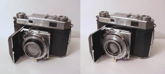

Hi All,
I was wondering if anybody here would be able to contribute some information about the Kodak Retina IIa Type 150 - there isn't all that much on the web. I just picked up an example off eBay - the pictures I show here are from the listing, not by me, as I don't have the camera yet. My camera has a Rodenstock Heligon f:2/50 lens, comes with a case, and a Kodalux L meter. It has also had a PC synchronization socket added - I guess I could remove that and replace the focus dial with one from a dud Retina II. From what I have gathered, 5107 of this model (IIa Type 150, all lens variations) were produced between 1939 and 1941, and it was only sold in Germany - which seems strange, as Germany was not yet at war with the States, and this was a more advanced model than the previous Type 142. Were German Merchant ships not able to get out of the Baltic Sea? - I thought that German Merchant ships were able to go to South America until about 1942.. By the way, I have already contacted Chris Sherlock, to ask him for information, in-case anybody was going to suggest.
Regards,
Craig - one very happy camera collector - It has a Heligon f:2/50 lens, for heavens sake!! :D :)
The Heligon is made in 1946 according to the serial number, so it probably comes from a post-war Retina. Is it coated?
Hi JPD,
No, I do not think it is coated. After hearing back from Chris Sherlock, he suggests that the Heligon lens unit may have been added at the the time that the flash synchronization switch was added. I wonder though if the camera wasn't assembled out of spare parts - a body left over from the 5107 run of IIa's, which was then assembled with a post-war lens and shutter perhaps, and then sold on by Kodak A.G.? But I am still happy with my literally one-of-a-kind IIa - though in the future, I might purchase a junk late model Retina II (Type 142) to take a an original shutter and lens from, to make the camera more original to the pre/just beginning WWII era..

My IIa with Xenon f:2.0 arrived today from Chris Sherlock, the Retina repair expert and forum member, after a full overhaul. The rangefinder now works correctly and the shutter runs as new. The focusing is much smoother, and I'm amazed how clear the finder is. :D Good work Chris!
I will load it with film and take test shots soon. The 2.8 Xenon on my other IIa is very sharp, and while I don't think the 2.0 Xenon is as sharp, I will probably be happy with the short DOF fully open.
(These Xenons are of totally different constructions, so it's not only the aperture).
I keep my IIa (150) open. For some reason the rangefinder refuses to show infinity at infinity most of the time it's opened. It then shows objects at infinity as 20 meters. This time I opened it, infinity is correct, but I had to open and close the camera 25+ times. :(
Chris Sherlock overhauled the camera for me, and he said that there are evidence that the camera had been dropped, so maybe something is a tiny bit bent or maybe a spring is damaged. The rangefinder mechanism is a precision instrument, so it doesn't take much for it to be misadjusted.
But at leat the camera is now usable!
