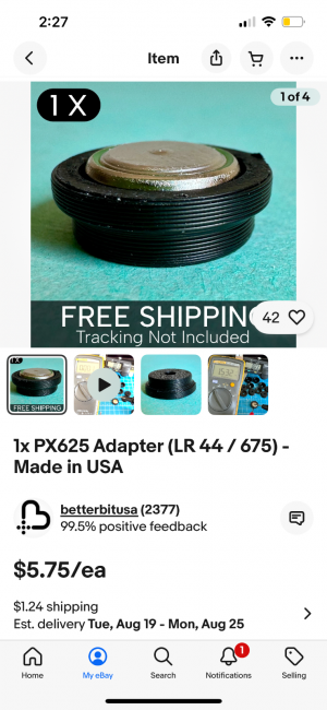

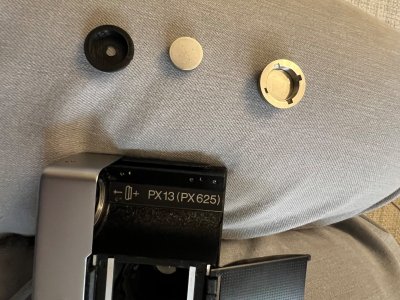

So I ordered these adapters for 675 batteries. I can’t get the darn battery seated all the way in there. If I’m looking at the diagram on the camera correctly it shows + side of a PX 625 facing up. Comparison h that to how batteries are in this adapter on the eBay listing it’s sort of backwards. The + side of a 675 battery is the totally flat side. Any idea what is correct?

I think that the picture in the advertisement is incorrect. The flat side (+) should face up -- that is, against the battery compartment cover.
Well I popped a wein cell in instead. It appears the meter is dead. I probably need to send this one back. Shame though. It’s a cosmetically great. No corner dents.
Before you send it back: is the Weincell good? You probably know that Weincells have a short life span…
The weincell was very old but unused. I’ll try the 675’s. I’m going to heat that adapter up and see if I can get it to seat. Still confused about the correct orientation.

I did something similar recently and had success. I can confirm the correct battery orientation is as shown below:
