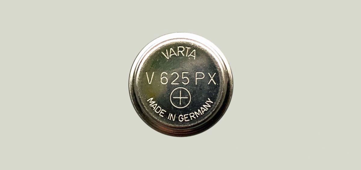

Banned Battery: Varta V625PX mercury cell, like others of its ilk, is no longer made or sold worldwide, but there are excellent alternatives.

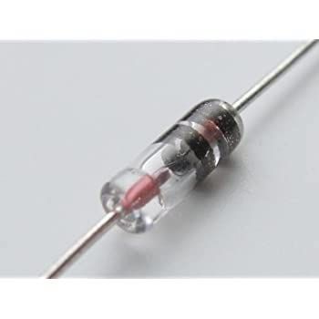

This 1N34 diode is permanently wired into camera's metering circuitry to allow the use of available silver-oxide or alkaline cells going forward.
The most common diodes used in this operation are the 1N34 germanium diode, which drops the battery voltage by 0.3 to 0.35v, the Schottky diode that drops the voltage by about 0.25v, and the silicon diode 1N4002, which drops voltage by 0.7v and is suitable for applications requiring two 1.5v batteries. All these diodes are wired in series with the battery, and they’ll work with silver-oxide cells (preferable because they deliver a steadier voltage) or alkaline cells (which drop voltage at a faster rate and should be replaced at shorter intervals—every year at least). Due to variations in metering circuitry, most competent repairman make sure to calibrate the metering system after modification to ensure that the readings are still within spec —make sure yours does so before sending your camera in.

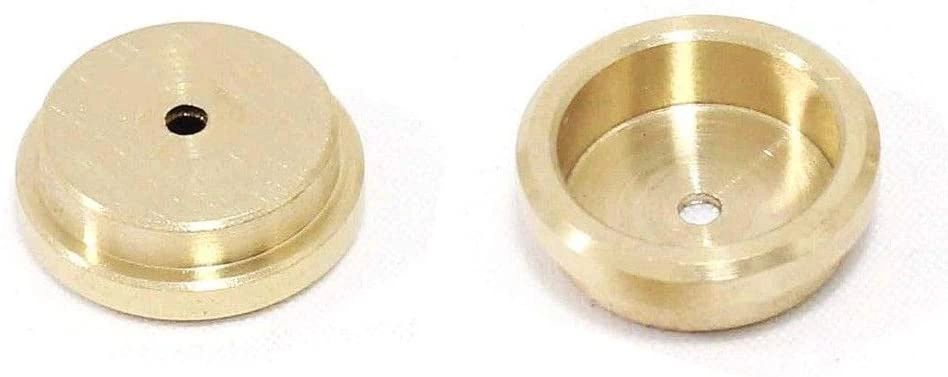

Warning: Not all adapters are created equal
There are many so-called mercury battery adapters offered on major selling sites such as Amazon that only adapt smaller batteries to fit larger battery compartment receptacles and do nothing whatsoever to alter the voltage of the inserted batteries. They may be of some value in other applications, but steer clear them if you’re aiming to use current silver-oxide or alkaline batteries in a device that was designed for mercury batteries. If you’re tempted, check out the scathing reviews on Amazon before you click “buy.”
Pretty but (mostly) useless, cheap size adapters like these let you put smaller batteries in bigger battery compartments but they don't alter the voltage.
