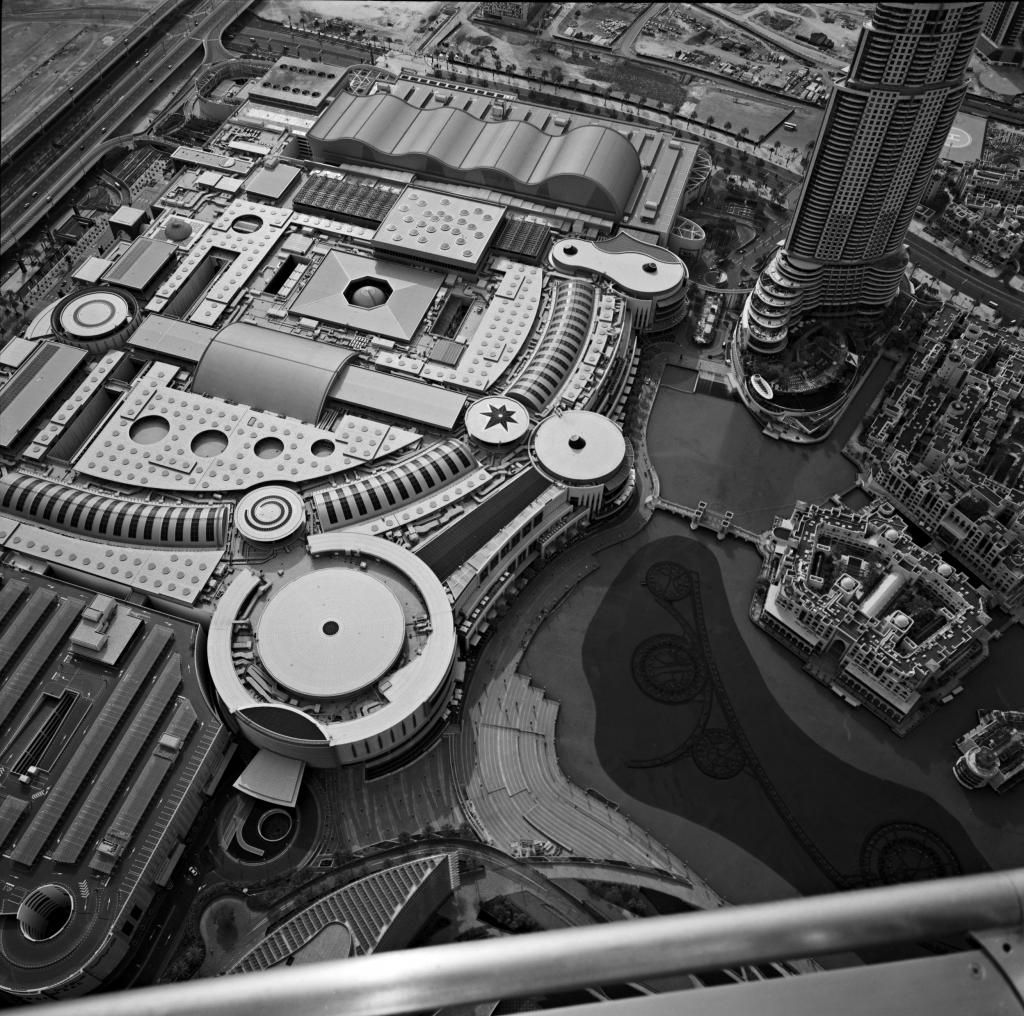

I used some on an overcast day last week, one roll done in caffenol-c-h for 12min @ 20C, the other in ilfosol3 for 5 minutes. Orange filter. I like this film very much, nice tonal variation and grainless. Might need to be tamed a bit more contrast-wise under bright conditions. Shot at EI 80, Mamiya 6/50mm. You can also get a decent IR Wood Effect using an infrared filter too, shoot at EI 3.
Caffenol
Ilfosol3

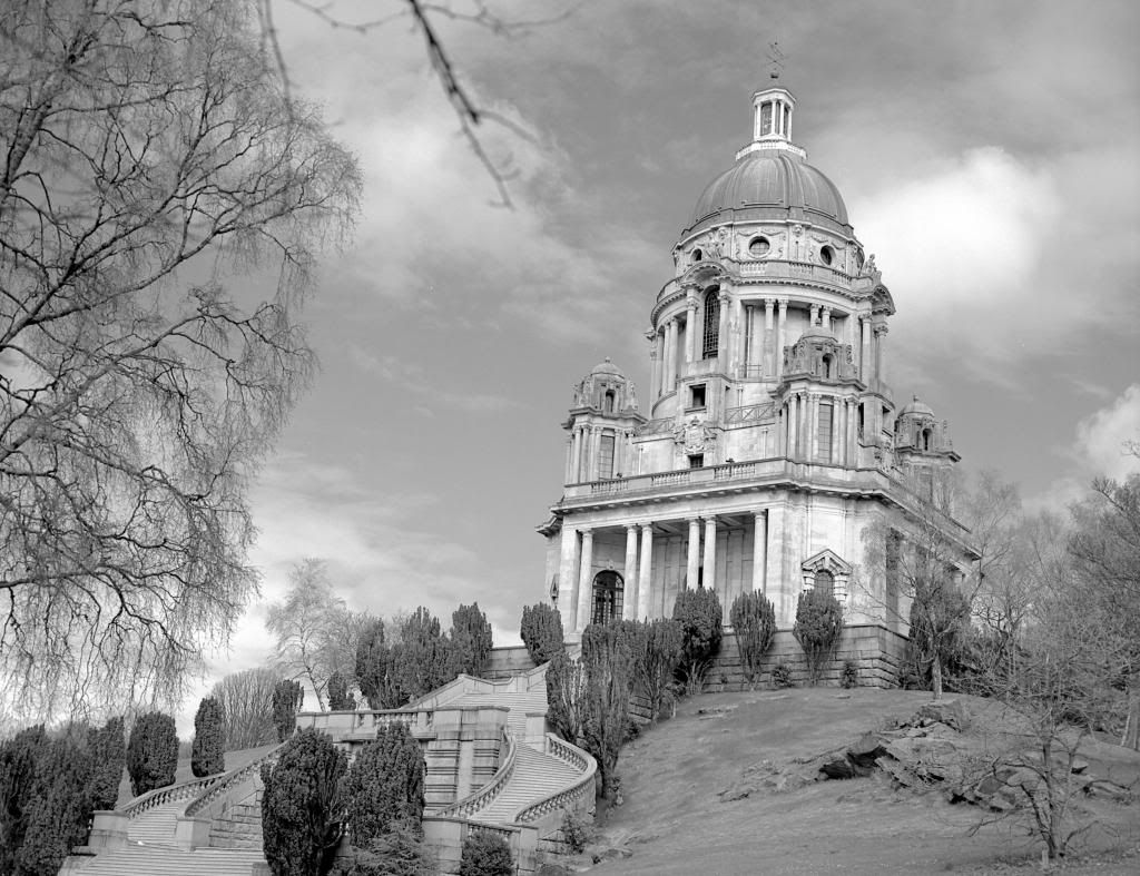

Got some drying at the moment from the ETRS (in Rodinal again) - some of which were taken with an IR filter. They look good so far - I'll post a couple later if I get a chance.
Swifty63 - those images are fantastic , the second one looks more like a circuit board than architecture !
Ignoring the cock-eyed composition, I tried it with a 3-stop red and a 720nm IR filter. Factor for the 3-stop was actually 1-stop (thanks to interweb research), and I used 5-stops for the IR (which worked out at IE 2.5)
An extra stop on the IR resulted in a rather dense neg.
All with a Bronica ETRS 75mm 2.8, Very hazy sunshine through thin cloud, film rated at a nominal EI 80, Rodinal 1+50
No filter :
Red filter :
720nm Infrared filter :
I reckon the IR side of this film may get some use this summer. Need to get hold of some Diafine though.
Thanks Peter and sepiareverb for your comments.
Peter those look good! The third one could pass for Dracula's castle with the darkened skies, nice effect!

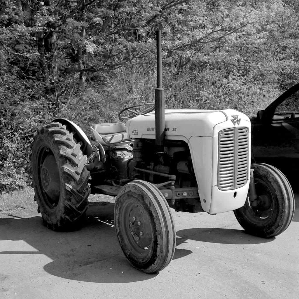

Works well with a red filter (only adding 1 stop of exposure to compensate)
Shadow detail on Retro 80S ?
I'm enjoying this film, and the lack of grain - seems to scan ok on my flatbed Canon.
