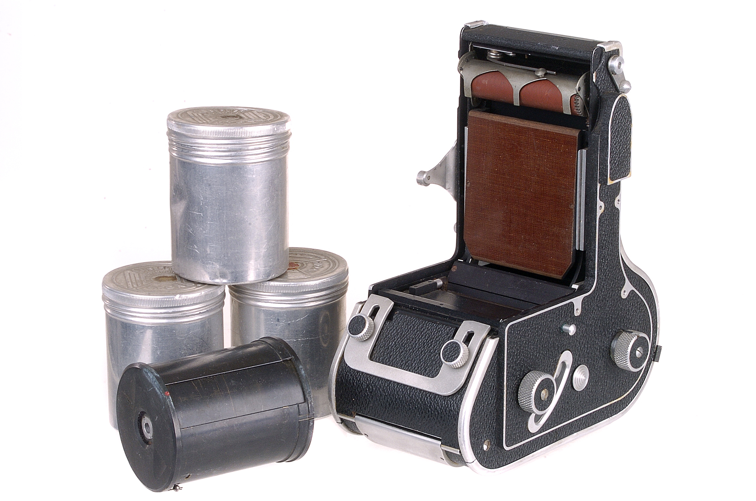

That's a strange thing. Any of you long time Rollei users come across this device before?
How does one advance film and re-charge the shutter ?
The two functions must occur separately film advance on magazine and shutter charge on camera ?
Does anyone know anything about this?

I saw one listed through a dealer. It has to be a special double capacity 70mm cassette in it. Standard 70mm cassettes hold 74 shots of normal thickness film.
I'd guess there's a special geared spool that fits in the takeup spool position. Again guessing, it would engage with the transport and film transport sprocket in the back. Cranking would transport the film and cock the shutter like with 120/220.
This was probably the medium format answer to the 250 shot GG and FF Leica and Nikon 250 motor drive / backs.
Journalists and event photographers might have used these. Even school photographers. The lens would be a touch short for portraits per the trends of that time so most likely it wasn't for portraits.
Yeah that all sounds about right.

Here's an image of the Mecila Mag 150 detached from the camera (quite a beast!):
It uses 70mm film. Now this is just too Kewl! 150 shots from a Rolleiflex. See my 70mm thread for info on how to feed this beast. The cassettes look to be special and totally custom. 🙂
Wonder what this would weigh on a 2.8 loaded with film. If it holds 150 shots what would translate to just over 30 ft. I'm going to bet loaded with film and installed on camer it would be 7-8 pounds.
