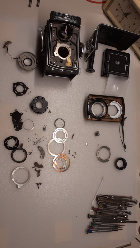

so heres my model 3 T being serviced overseas hoping to receive it within a couple weeks 🙂
looks like a big job—dont try this at home folks

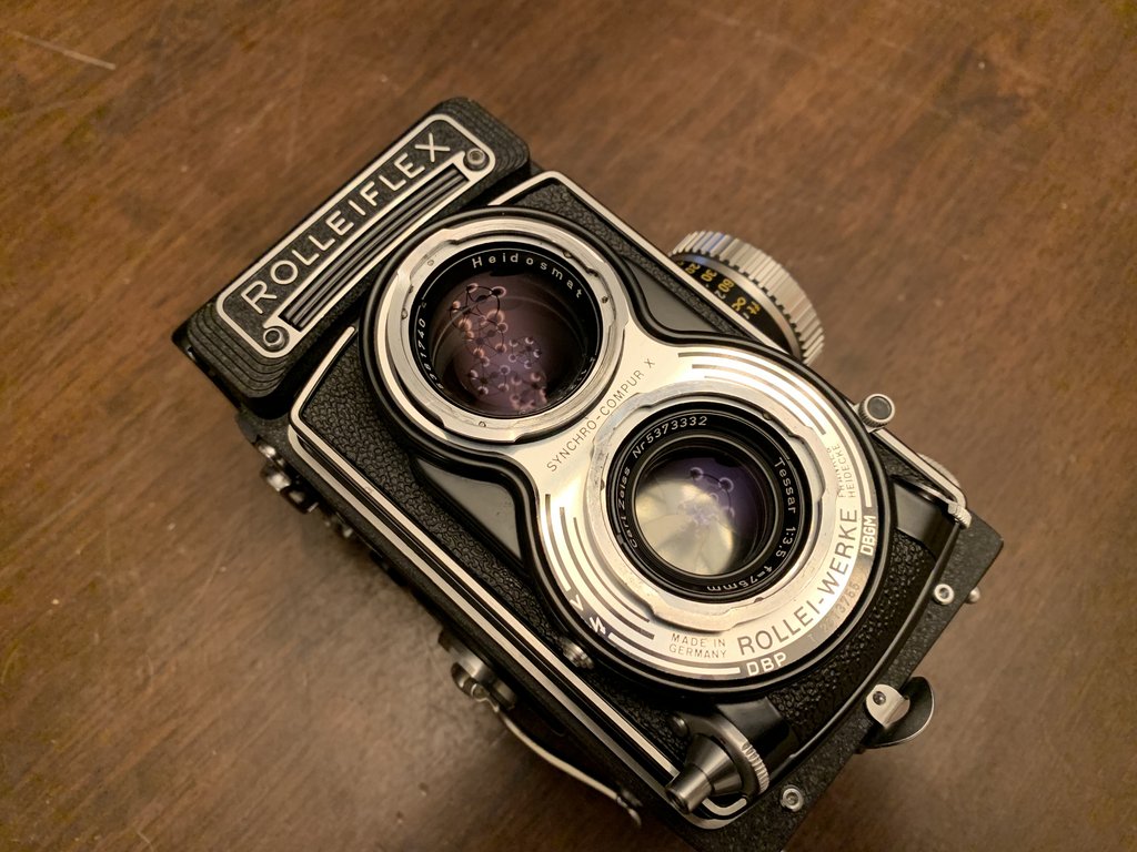

it feels wonderful but i have to echo dan’s previous comments about the wind mechanism—it just feels clunkier. but in operation, works just fine. with an automat, a planar/xenotar or a ‘cord, you just feel the film advancing very smoothly and i guess with the T i would describe it as feeling like a ratcheting mechanism.
i also dislike the aperture/shutter speed being coupled, similar in operation to the 2.8C and first model F’s. but it feels much smoother and lighter action than those models coupling mechanism. to be honest my favorite f stop/shutter mechanic is on the rolleicord. idiot proof. The T is in a middle ground.
looking forward to seeing how the first roll comes out

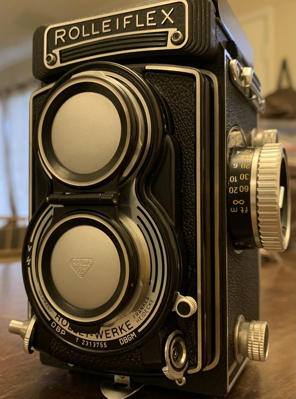

With the "Rollei Werke" and focus knob marked in both Meters and Feet it makes the camera fairly "new", and not long before the "White Face" front plate. You'll get used to the coupled setting lever.
I hope you will love the improved Tessar.
