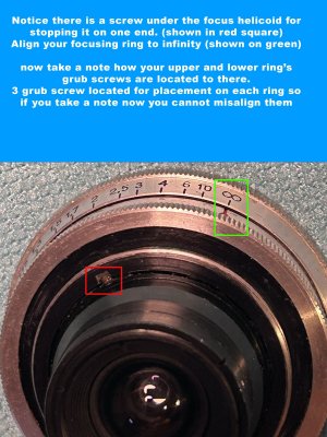

Disassembly -

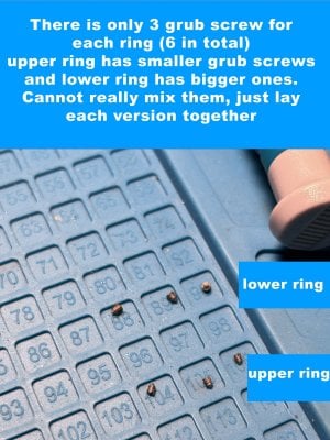

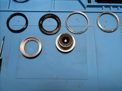

Just unscrew 6 grub screws here
Take off two rings
Locate them separately, but even mixed can be easily divided again (If you still have your eyesight nicely, I'm 24 years old... Would be harder if I was like 60 years old or so. Anyways... do what you want I'm not here to judge you)

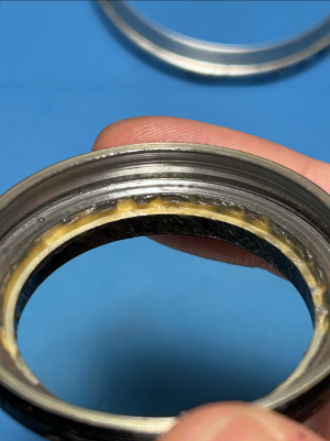

After taking off the black ring I mentioned above you should be able to pull this part form the lens just by taking it off with your hand
You should see all sort of disgusting soviet grease inside like this.
Use qtips to take big chunks of it and then use acetone dropped qtips. I lost the count of the qtips that have been used for this russar, more than 40 I guess.

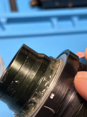

You can remove the ''black ring'' which holds the optical block now. I did wrote to remove it but when this ring removed the block simply comes off. I waited until this point and removed like this.

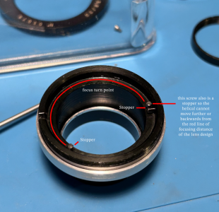

You can see the helicals right now. They were not clean like this, lots of dirt and debris inside. But again, I forgot to take a picture. I get too focused on the repair I usually forgot to take pictures.
Once the helicals disassembled, you can see them in parts like this. On right side you can see the shim (and a screw inside the shim.) that screw is from the helical assembly which I unscrew to disassembly, and that shim is locaed inside that placement that you see on the black part (left side)
I saw lots of dirt and debri here, even on the shim which needs to be perfectly flat. I proceed with cleaning.
This is the orientation of the parts.
(note - that side oritended screw is put wrong on the picture seen above, sorry for inconvenience, it is oriented between the two stopper normally.)
