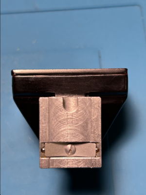

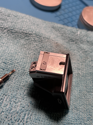

Now, your viewfinder should look like this underneath. can vary a little bit but you can do CLA any variant similar with this method
BEWARE -
take pictures at every step, if you find any parts when you take off a part, take more macro detailed pictures or draw small illustrations about how they are oritented (which way etc.)
you should be good.

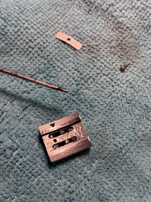

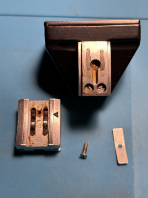

After taking our first screw
we should see the disgusting old soviet gunk now.
Our first screw just came off, it is extremely distinguishable since it's our only screw with a dome like tip
The way this assembly works is that it is built like a sled, so it moved at an angle which would change the angle of our optical block, that way we can compensate for the parallax. I made some small tests with my Sony A7SII by looking both at the Russar VF and comparing it with the screen image it is actually pretty decent if you wanna take 0.5meter focused pictures.
Yet, compared to other viewfinders it is extremely big.

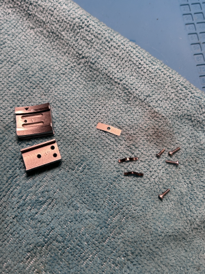

You will notice two little pressure plates hidden inside two identical hollow compartmens inside the sled once taken apart. they are extremely hard to see for their orientation since they are covered in grimy gunk. Use some wood toothpicks or something to take off the gunk carefully (careful now to now lose them, they do not have any tension though)
take note how they are oriented now. You should be good. They are pressure plates to give a little bit tension for the moving parallax sled.
The upper side of the sled which is connected to the main optical body with three screws. Also covered in gunked up grease. I first cleaned the gunks in big chunks with some toothpicks. Then I simply unscrewed three screws to further disasembly. To my suprise there is nothing more to diassemble here (more on that later) It's literally 3 threaded holes over this part and nothing else.
Some hot soapy water and a hoard of qtips made a good job. Dont rush to your washroom. Get your hot soapy water into a canister and use a toothbrush to clean the parts inside the water on your desk.

Some macro shot showing our pressure plates. They are clean now.

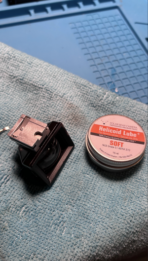

I am relubricating the sled parts now. Using Polar bear Camera ''soft'' helical grease. It is what I have and I wont mind. The quality of these greases are not bad. they are usable between -40c and +120c which is fine, you would die out of this range of weather conditions. Don't get grumpy about this and that...

this is the view from the bottom

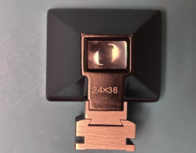

The top view, showing F: 2.0cm (F for Focal and 20mm in old cm terminology)

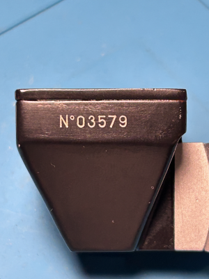

Right side showing the serial number for the viewfinder. Mine is No. 03579

View from the back. also a 24x36 lettering can be seen indiclining it's made for 35mm photographic equipment
