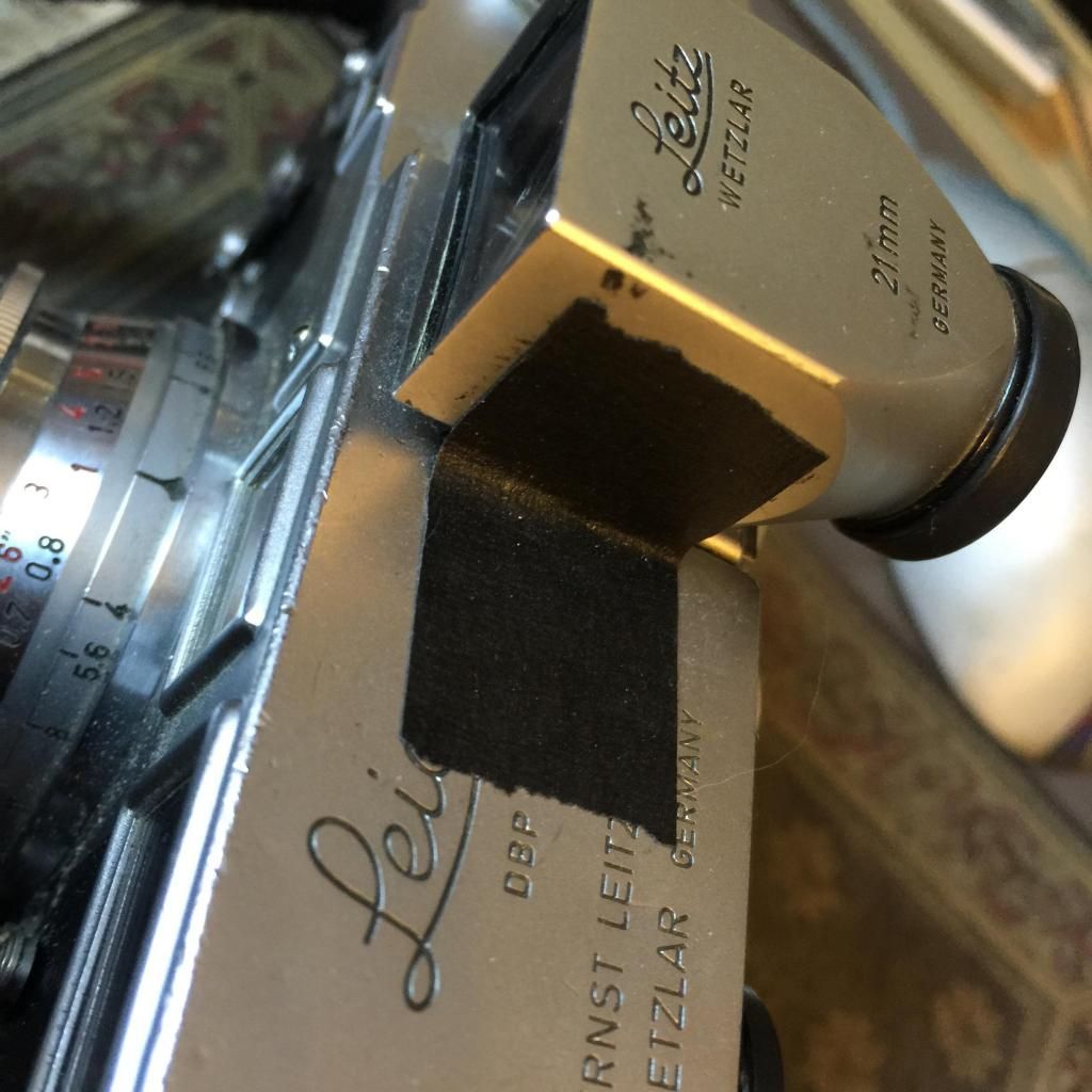

Fit a piece of electrical tape, maybe two, to the bottom of the finder shoe. It takes space and adds friction, both. Make sure the tape goes all the way across in contact with something--down into the gap, not bridging it.
The iii had nothing to hold the finder in, no springs or anything, just a couple of dents downward, so I put a strip of tape across the top of the camera, up the side of the finder and over the top. I do this with any finder, on any camera, and have never lost a finder in 45 years. Keep a couple of extra strips of tape on the bottom of the camera so you always have a fresh one.
