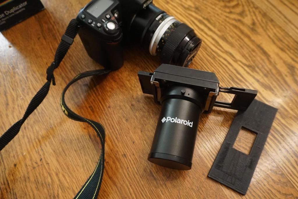

I also have a Nikon 55/2.8 Macro AIS with an extension tube for 1:1 capture; a Nikon slide copy attatchment; and a Gepe light table for illunination. All I really need is a Nikon DSLR, but this is way-way too much work.

I'm impressed by, and slightly jealous of the slide copying apparatus.
But I suspect there may be some cropping involved.
