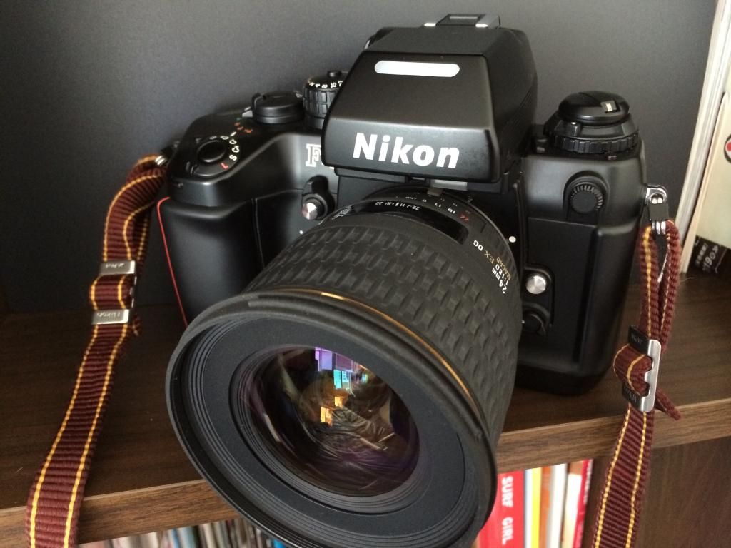

I just picked up a Nikon F4 with a Sigma 24mm f/1.8 lens for this kind of shooting. The AF seems to work quite well in low light, and the camera has a "silent" shooting mode, which while not as quiet as the silent mode on a Hexar AF, is still much quieter than a regular SLR. The 24mm has an advantage over the 35mm Hexanon in close quarters (small restaurants and bars in Tokyo are indeed small).
