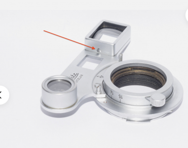

Just a thought . . . on some models, maybe all, there are two screws located on opposite sides of the rectangular window which appear to be holding either the glass or the frame in place. I'm wondering whether the previous owner might have removed that window to clean it but re-installed it upside down. I can imagine that causing the misaligned view if it were flipped by mistake.
