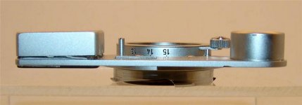

I recently picked up a SOOKY-M (aka SOMKY?) close focus adapter. I've read that it works with the original collapsible Summicron 50, the collapsible Elmar 50/2.8 and, with a further adapter, the removeable lens head from a rigid Summicron 50. Having just received the SOOKY-M, I have only tried it out with my Elmar 50/2.8 on my M3 camera. Would like to be able to use it with the lens head from my rigid Summicron so if anyone has a UOORF adapter they would be willing to let go please let me know.
Using the SOOKY-M adapter seems easy enough. The bayonet mount on the back end of the collapsible lens barrel mounts on the SOOKY-M and then the SOOKY-M mounts on my M3 just like any other M mount lens would. Turns the whole thing into something akin to an M3 with a Dual Range Summicron mounted on it with the big difference being one only gets close focusing ability with the SOOKY-M adapter which must be removed if one wants to focus on anything beyond the close focus range limit (something like 3+ feet).
Anyways, the SOOKY-M adapter I got did not come with any instructions so if anyone has any I would appreciate a scanned copy. Obviously, I've already figured out how to use it but any additional details would be great to know.
But I do have one question. There is a relative scale of some sort created by a marking on the main body of the SOOKY-M as it aligns with markings on the corresponding rotating focusing element on the SOOKY-M. I've included pics below to highlight what I mean. The first pic shows a front view of the SOOKY-M with a marking of "1:" just above an arrowhead shaped marker pointing towards the rotating focusing element. The second pic shows the corresponding marking of "15" on the focusing element. The corresponding markings have a range of 7.5-15. What I don't know if what, exactly, do these markings mean? Is this simply a gross relative scale with no correlation to anything in particular? Or do these markings really indicate something useful? Any thoughts or info would be much appreciated.

Hi,
vrgard said:
Ahh, I hadn't considered that Roland. So the 1:7.5 is a macro enlargement of 7.5x (and 1:15 is 15x) full size or real life?
1:1 is full size real life. 1:15 is 1/15th or 0.15x.
Look out, the rectangular google of your SOMKY is broken, or not in place. Look at both screws on the sides, maybe they are missing?
I have this SOMKY/16507 with the UOORF adapter (not for sale sorry), but if you're serious about close-up photography, i would suggest to use the Dual Range Summicron instead.
Thanks Philippe for the further explanation. Isn't 1/15 more like 0.067x and not 0.15x? And isn't that a fairly significant amount of enlarging magnification?
And not to worry about the rectangular goggle. Those pics weren't from my SOOKY-M (which is just fine with the screws intact).
Lastly, can I ask why you advocate the DR over use of the SOOKY-M? I'm not planning any serious macro work so I'm happy with the SOOKY-M but am curious about your thoughts on the subject.
