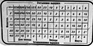

Dear Buddies!
When the first Zorkis were made, exposure meters were not common. I have already seen a strange card for calculating exposure, but I cannot read the Cyrillic letters. How to use it?
An other tool for proper exposure is the Fotoexponometr. Could someone translate the inscriptions? I would like to make an English equivalent.
http://www.flickr.com/photos/anssipuisto/4495054316/
Thanks!

Dear Buddies!
Thanks!
I too would be interested in a translation of the words on the card. I have an identical item which came with a 1952 Kiev-3. I have seen number of plastic cards in the leather cases of Zorki cameras, but they have been blank. I wonder if they originally had a printed exposure guide that has been erased.

This table from the photo is nothing more, then elaborated rule of sunny-16. The one on Your picture is quite complicated, with compensation for the month, and for the hour of the day. It is calculated for latitudes between Kiev and Leningrad, today's Sankt Peterburg, and comes with three sensitivity scales: Russian Gost, German DIN and something I don't know, where ISO 250 is represented by number 3000, but not quite linear like ASA or ISO. Nevertheless the user have to decide the weather conditions, so we are back at "Sunny-16". This tables were made for people, who didn't master the basics of photography and are good only for general picture taking. Like on vacation, forget more complicated lighting situations.

Dear Buddies!
Thanks a lot for your photos and explanation. You are the kindest guys all over the world. But the problem of the single exposure card remained open: what it is, how to use it? These cards were attached mainly to the early Kiev cameras. In the camera cases there were a tiny pocket for them.
On top of the card = Read exposure
Very bottom row =Calculated exposure
Three lines on penultimate row= Part of second, Seconds, Minutes
Vertical text - could not read it, too small letters...
