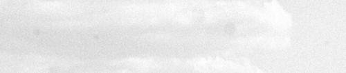

what are your usual suspects for the kind of dark spots shown here?
film is PF4, dev is D76 1+1, the day after it was mixed, filtered through chemex filters. Fix is Tetenal 1+9, one shot, also filtered.
water is from an inverse osmosis device.
thanks!

Dust is not the issue here, but you raise a valid point:
maybe the developer was absorbed unevenly at the first stage of the process and a presoak could take care of that (?)
... if it's bubbles they will be perfectly round if they formed on a flat surface, or slightly elliptical if the film was on the spiral
Also, air bells also usually produce spots that have a darker "ring" around the edge.
To finish rounding up "the usual suspects":
  • mixing powdered fixer in a room with unsealed film (e.g. loaded film tank, ...). The "dust" from the powdered fix can easily pre-fix a spot on the film which then won't develop, leaving a clear spot on the neg and a dark spot on the print.
  • incomplete mixing of powdered fixer resulting in crystal of fixer being left on the emulsion and not washing away efficiently thus bleaching the image around the crystal as is very slowly dissolves in the wash.
  • mixing of powdered developers at too low a temperature or simply incompletely leaving small crystals floating in solution. More often than not, though, this produces dark spots on the negative resulting in light/white spots on the print.
What ever it was, it was something that blocked development in that spot or something that bleached the image after it was developed.
The best procedure is to fill the developing tank with tempered developer. Then remove the loaded reel from dark storage and drop it into the tank, cap and begin inversions for 30 seconds. The first 30 are critical.
If you use a plastic tank, just dump in and use twist stick for 30 sec, can and invert for balance of time,
Do not over fill tank or agitation is limited. Agitation is necessary, not bad.
My favorite is a two reel tank, one loaded reel on bottom, empty on top, 8 oz of developer, yes half full. Agitation is by inversion.
tap the tank on counter top after immersion and after first 30 sec.
When you start getting black flecks on the film, it is from silver precipitating from previous film. I use fix only one time.

... It was the lack of that meniscus line which made me question my diagnoses
Fixer is liquid and the developer was filtered, so I guess that rules out the floating developer crystals.
I think you nailed it.
thanks a lot.
Now, how do I make sure I don't get these in the future?
isn't one full minute of inversions enough to dislodge bubbles?
... I tap the tank on the worktop, and do rotations rather than inversions ... inversions always seemed to be asking for trouble
Are you sure those are not marks from a dirty lens?
Not sure if those are from processing
Processing marks are usually a lot darker/lighter and more defined
