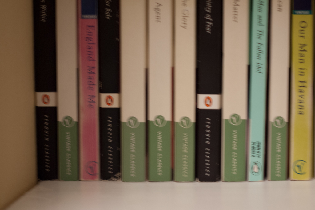

This first shot is done with me holding the camera in front of me, using the LCD screen to focus and frame the shot. You can see that there's plenty of camera shake.

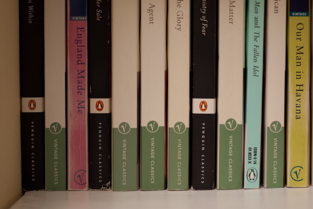

This second shot above is using the electronic view finder (EVF), holding the camera up against my face. There's still camera shake, but it's much better bracing it as one does with the EVF. However, the viewing through the EVF is not very pleasant after several photos.

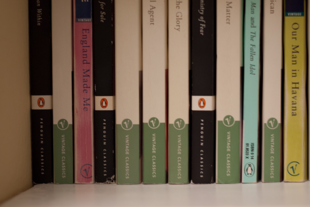

This third one is done using a small hand bracket and holding the camera in front of me, using the LCD screen for focusing and framing. It's a close call between using an EVF and a flash bracket. However, I think the bracket is a bit steadier. I've tried multiple times to shoot this photo under these four basic arrangements--so as to make sure that it was me shaking more one time than the other. The results almost always came out the same: the EVF is always a bit better, but sometimes much better than nothing. And the flash bracket is always much better than nothing, and sometimes noticeable better than the EVF. I did try both the EVF and the flash bracket together, but the combination didn't seem to affect the results.

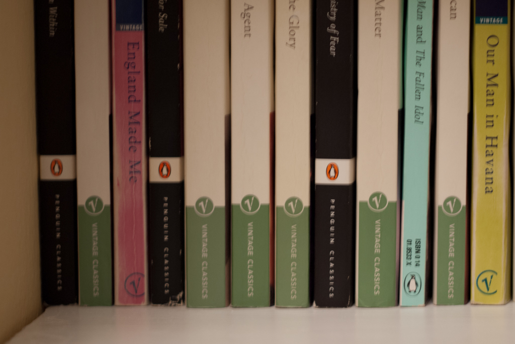

This last one is done with a tripod. It's a very clear image. If I have the time and all to set up a tripod, it obviously gives the best results without image stabilization or bright lighting (e.g., a flash). However, I think the best balance between image quality and most convenient method in low lighting may be to use a flash bracket like I did in the third photo above.

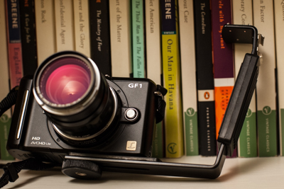

Above is a shot of the camera with the small flash bracket I used. It's not very big, but it is appropriate for the size of the camera and it widens the base enough to minimize the results of my hands shaking slightly. It seems awkward looking, having a flash bracket without a flash attached, but the results are better and it's easier to handle the camera even when not shooting.
