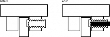

I can understand drilling the head off a bolt so you can pull the casting or whatever off over the exposed bolt shaft, but how does this work with a grub screw? If you drill right down to the end, aren't you left with all the threads still there? Having a bit of trouble describing this, I'll draw a picture.
In the attached picture, if you drill away what is marked in solid black, won't the remaining bits of grubscrew still stop you from lifting away the shutter speed dial (or whatever else you can imagine a grub screw holding)?

with the drill out method i use there is usually just a tiny amount of metal left in the thread and in your example will pull past easily. The tapping a sharp screwdriver method works aswell.
