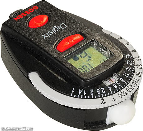

I recently got a Gossen Digisix lightmeter to go with the meterless M4 and was planning on using it as an incident light meter. After about a month I realize I was possibly using it "wrong" :bang:
The Digisix has the white dome pointing outwards rather than on the same side as the screen, meaning if I hold it in my palm and point it to the subject I'm actually doing a reflected reading (right?)
Here's a picture to clarify:
http://www.kenrockwell.com/tech/gossen/digisix/D3S_6377-460.jpg
So if I understand correctly, due to the placing of the dome I actually have to hold it the OTHER way around, from the subject pointing towards my lens ? (the manual simply says "press the button to take a reading")
If this is the case how do I shoot something far, a hill or a car across the street ? Am I understanding this correctly ?
go easy on the village idiot here

right now you have it set to incident mode. And yes you would be correct. See if it has a reflective mode. That'll allow you to use it as you're used to built in meters in most cameras. IIRC you should just be able to slide the dome over so that it's not in front of the sensor.
skipjack
If you are using it as an incident yes, you leave the plastic dome in the center and face towards the light away from the subject, as if you were the subject looking at the light source. You can slide the plastic dome away from the sensor and use it as a reflective meter - pointing it at the subject, as if a meter in the camera.

ah I see, thanks a lot guys. I wanted to learn how to use incident metering because I've always done reflected with the M7

I have a Digisix. Unlike Stewart's photo of his light meter above there is not much space for stickers and the read out is just a number. I get best results by sliding the white dome aside, then pointing it around to get readings of the sky, ground, objects and shadows to get a range, then putting my exposure roughly in the middle. It's not as precise as a spot meter, but then it didn't cost as much either.
Cheers,
Rob
Cheers,
Rob
Nigel Meaby
Yes as Rob said just slide the white dome ( which is actually called an Invercone) to the side to take a reflective reading. You cannot take a reflective reading with it covering the light measuring aperture.
An in-camera meter is taking a reflective reading. So if you want to use it as if it was inside the M4 then a reflective reading is what you need. If you have a static subject that you can go over to then slide the dome back over the light measuring aperture and do an incident reading, pointing the meter away from the subject.

If I'm not mistaken, point an incident meter toward the camera from the subject's position, not necessarily toward the light.

If you are using it as an incident yes, you leave the plastic dome in the center and face towards the light away from the subject, as if you were the subject looking at the light source. j
Read below.
In this mode, the DS measures from the subject
towards the camera.
Point the dome of the incident meter towards the camera from the subject. To do otherwise might give a wrong reading, although perhaps not too much. It would depend.
And as mentioned above, what I always did for landscape or other subject not close enough to walk to, was to just hold the meter up at arm's length (from the front of the camera, or just beside it), align it so the back faced the subject and the dome towards the camera, and use that reading. Always worked for me.

Well, sometimes I point the dome towards the camera, sometimes towards the light, and sometimes slightly turn it in a way that it measures the light in shadowed areas of my subject. So it all depends on what I'm trying to achieve.
