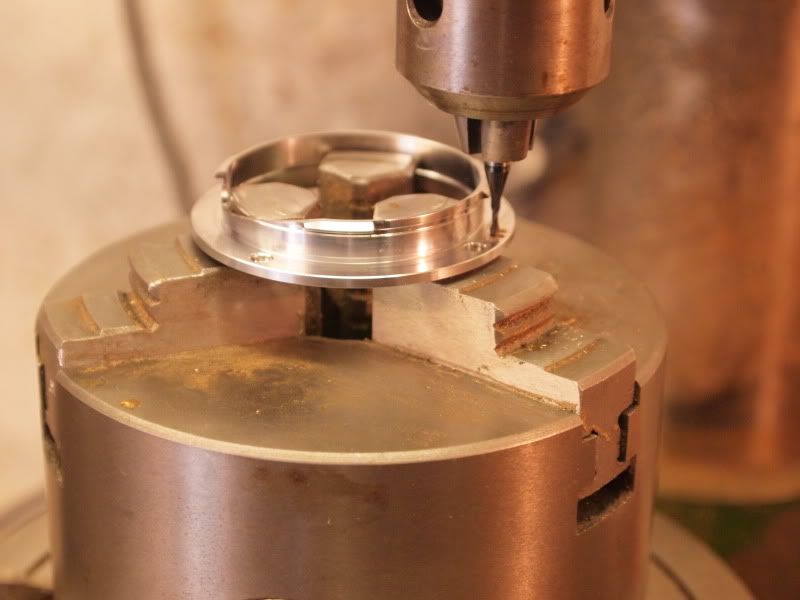

Thanks for the answers, it's for use with an M8, I have the facilities at home to mill the lenses for coding using a milling machine and rotary table. I think I will code the 50 so as it shows in the data and that leaves the 35 as the only lens I have that isn't coded so it easily identifiable later. I'm a bit wary of coding this lens as it doesn't have a flange mounted similar to most other lenses, the mounting on it is fitted a different way and also has the helix for focusing machined in it.
Here is photo of a Zeiss flange being milled
