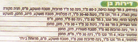

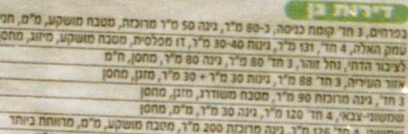

I'll post a small, central part of my tests so you can get an idea of what I'm talking about.
BTW, I see now that part of my tests were done on a IIIc which exclude the adapter problem.
Those who think the resolution is crappy on all of these because they can't read, don't worry, it's Hebrew ;)
I hope I'll get it right but it's the first time I post pictures so...
The first one (former post) was canon 1.4 fully open (BTW I was really blown up by this one)

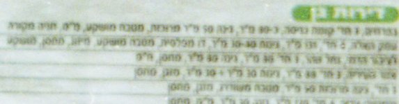

Now the summicron

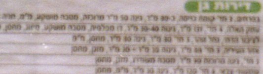

Summitar fully open
Does that kind of difference make sense to you?
Thanks!

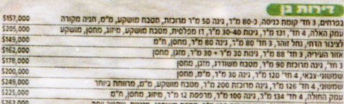

Just for scale
Just for scale
Here is the full picture...
The black area is approximately what has been enlarged in my former posts.
Have fun...
