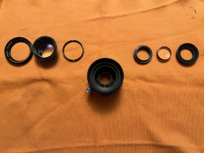

Thanks for getting back to me so quickly. I did reference those guides from Richard Haw, but I don’t think the lens is constructed quite the same unless I’m missing something obvious.
This is where I’m at right now. I’ve removed the rear rear retaining ring, rear optical group, and then another ring. From the front I also removed the name plate ring, front optical group, and another retaining ring of sorts.
I don’t see any other rings or screws in the front or rear of the barrel to remove in order to separate it further.

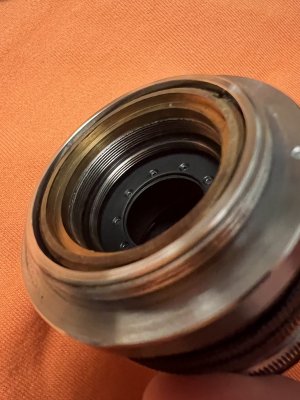

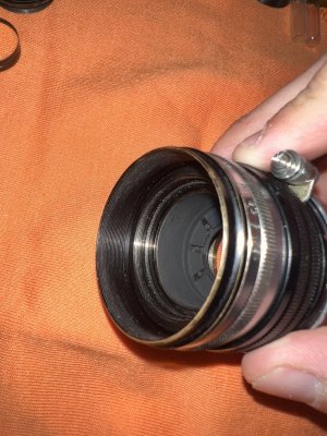

Actually ignore all that. I just wasn’t pulling hard enough. I got it to separate. It was just stuck on much harder than I expected and I was worried about breaking it.
Thanks for posting the detailed images! On mine, the barrel dropped out of the focus mount easily. I thought you were asking about disassembling the focus mount itself.
I have seen some lenses where the grease gets like glue and keeps things in place that should come apart. I've resorted to removing glass, like you did, and letting the remaining part soak in alcohol for days.
