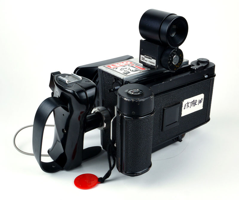

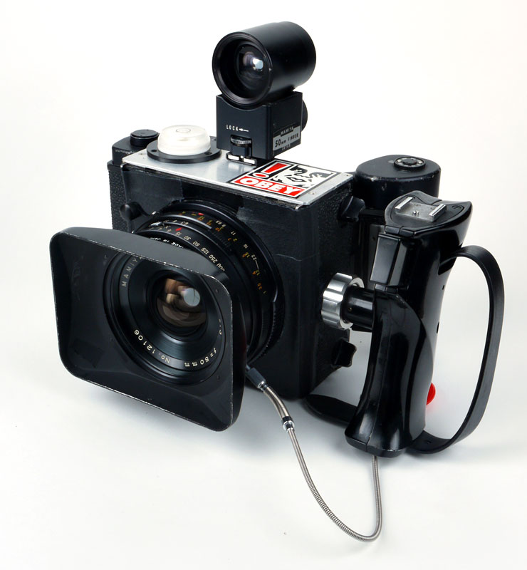

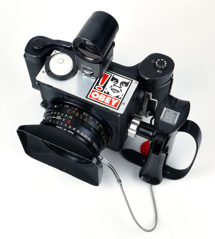

I have three bodies for my Mamiya Press kit. A chrome Universal, a black Universal, and a Super 23. The Super 23 had a bad rangefinder so I flat topped it. It makes a great platform for the wide angles. I picked up a 50mm/f6.3 (21mm eq with a 6x9 back)) at a reasonable price with a non-working shutter. It came back from the shop today. It's a biogon design. I'm pretty excited to see what it will do. The 50 also fits on the Universals and is rangefinder coupled with them. Landscapes here I come!

I finally stepped up for the 50mm Mamiya Sekor
Four of the 50mm lenses came on eBay last month and sold for $457 to over $800. I was the winning bid on the 457$ auction. The lens is near mint. both caps, viewfinder and hood.
I was shocked to see all three remaining lenses go up increasingly to the over 800$ amount. There are two on currently.
I have been using the Fuji G690 for some time and have had no complaints. However, I always felt that if I could rationalize the Mamiya Press 50mm lens for 6X12, I would flat-top another Universal and shoot really wide 6X9, and build a 6X12 back, as it's possible to hog out the Universal body to 6X12.
So, here we go again. Owned a bunch of Mamiya Universal stuff before the Fuji rangefinders. The lenses I want to use are the 50, 75 (which will also cover 6X12 and close to 4X5), and the 100. I've used the 75 on a 4X5 and without movements, do get a little vignetting. The 50 should almost do the same.
