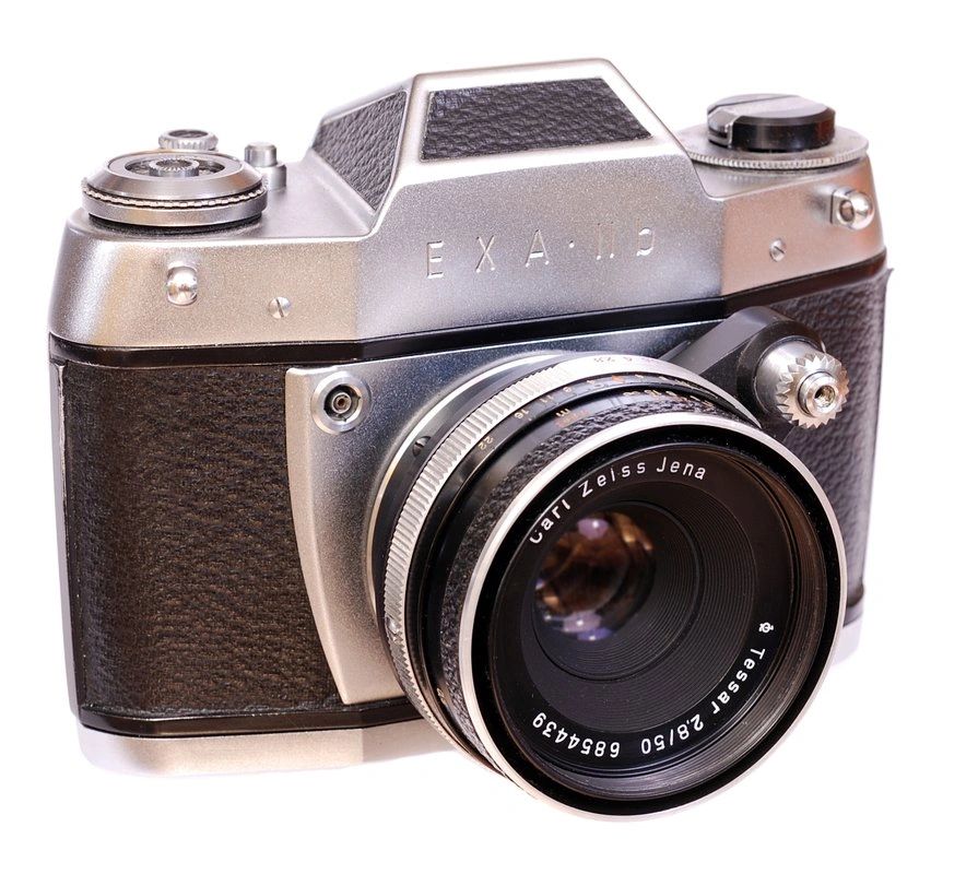

The last two classic Exa models, both closely based on the Exa IIa, had cloth focal plane shutters, fixed eyelevel prisms, shutter speed dials, wind levers, and rewind cranks—just like any modern 35mm SLR. The Exa IIb of 1964-1966 and the Exa 500 (aka Exakta 500 or VX 200) both incorporated instant-return mirrors, and the latter had a top shutter speed of 1/500 sec.
rs=w:1440,h:1440
Exa IIb with 50mm f/2.8 Carl Zeiss Jena Tessar.
