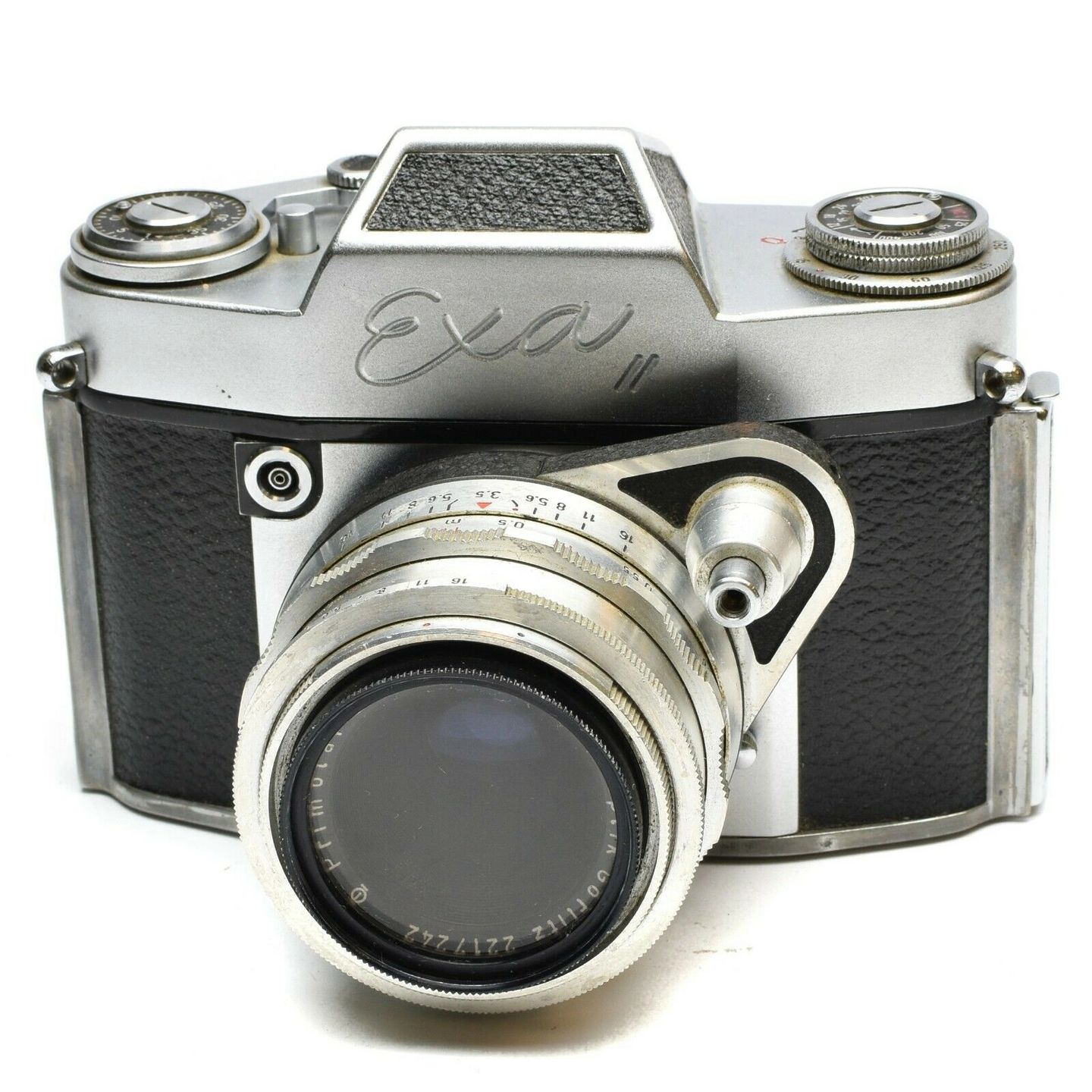

Now let’s back up about 17 years to next “real” bayonet-mount Exa, the Exa II of 1960-1969. It bears a close resemblance the Exa I except that it has a fixed (non-interchangeable) prism finder, a less rounded body, and (like the Exa Ia) a film wind lever with coaxial shutter speed dial. However, that dial now provides shutter speed settings from ½ to 1/250 sec, in the modern geometric sequence. How can this be? Swing open the new hinged back and you’re greeted by a conventional horizontal cloth focal plane shutter instead of the distinctive “mirror shutter” of previous Exas! The 1963 version of the Exa II, dubbed the Exa IIa reverted to the more rounded body shape and removable back of the Exa I, added a rewind knob, deleted the neck strap eyelets, and added a shutter lock button on the back. The final 1963-1964 version of the Exa IIa added neck strap lugs and replaced the back-mounted shutter lock button with a lever.
Exa II sporting 50mm f/3.5 Meyer Primotar with external auto diaphragm.

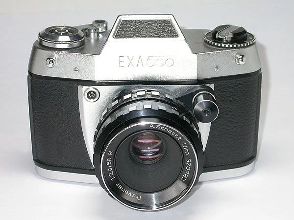

The last two classic Exa models, both closely based on the Exa IIa, had cloth focal plane shutters, fixed eyelevel prisms, shutter speed dials, wind levers, and rewind cranks—just like any modern 35mm SLR. The Exa IIb of 1964-1966 and the Exa 500 (aka Exakta 500 or VX 200) both incorporated instant-return mirrors, and the latter had a top shutter speed of 1/500 sec.
Exa IIb with 50mm f/2.8 Carl Zeiss Jena Tessar.
Exa 500 with 50mm f/2.8 Schacht Travenar R, a good quality Tessar type lens with external auto diaphragm.
