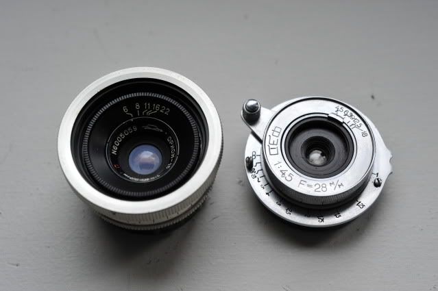

On the net I found a technical description of the 1938-produced FED 28mm 4.5 wide angle lens. I was astounded when reading its description. If ever there was proof of the Russian optical industry being able of much more than simply copying Leitz and Zeiss designs, this is it.
This is the lens it's all about:
And it indeed does look a lot like a Tessar design, or the Leitz Hektor 28mm 6.3 lens.
BUT: this lens has SIX elements, which are ALL air spaced. The front element is only SEVEN millimeters wide. The most extreme feat of engineering is the third element, which is ground to only SEVEN TENTHS of a millimeter thickness. :eek:
I was shocked.
I looked at the nail of my little finger: the third element was probably as thick as that, but MUCH smaller. And it had to be ground, placed and aligned properly.
I managed to find a lens diagram on USSRphoto.com but it's as tiny as the lens elements itself:
The third element from the right is the small peak of engineering.
As rumour goes, this lens is sharper than the Hektor and maybe even the Tessar.
There is a downside though: the lens almost always has to be collimated to the body it will be used on, since it's a pre-war FED lens. FED did not introduce standardization until after WWII, before then all lenses were made to fit bodies, like Leitz did before standardizing production. One could use the lens as a scale focused lens, but that would be a waste of the maximum speed of 4.5 I guess.
Now why did I bother to read up on this? Well, I bumped into one today and it was cheaper than that Tessar lookalike the Orion 28mm 6.3 lens. And as I'm the owner of a FED-S with 50/2.0 Summar clone and 100/6.3 tele, I figured it would be nice to have a third lens that belongs to the FED prewar system cameras.
My camera has been to Yuri at Fedka.com and I may have to send it over again to have this lens collimated to the body once more. Fingers crossed.
Orion-15 is Topogon type, not Tessar. A very, very different design, very painful in manufacturing.
No wonder, the Orion-28 is pretty rare already by itself and has the advantage of being useable on all sorts of LTM bodies. (The Orion is also an extremely cool lens, completely distortion-free by virtue of its symmetrical construction.)
Nice find either way, I've never seen one "in the flesh". Try to see (carefully) if it screws into an LTM body at all - that may depend on the thread pitch of the lens mount. If it screws in, have it collimated not to the body, but to the LTM standard, and you'll have a nice wideangle.

I would be truly amazed if it screwed in all the way, my FED 50/2.0 does not fit onto a Barnack like it should. Nor does the FED 100/6.3.
Anyway, I have a Canon 28/3.5 that does the wide angle job on Barnacks, the M2 and M3. So this one will be dedicated to the FED Komandyrski. Let's hope it fits 'right out of the box'!

The two generations of Russki 28's are very different in construction, and I wonder why the older FED design was not picked up after the war. I have had very good results with the Orion lens, but I have found the contrast of the FED to be very low. I suspect the problem is with my particular example, which is somewhat foggy. I'll have to get brave and take the tiny little thing to bits to clean it. Congratulations on getting the set of lenses for your FED S; it is not easy to find these things.

Well I have a roll here that needs scanning, and the lens is not fogged. It is sharp, but shows bad flare, and I mean really bad. Will post a few shots as soon as I can.
