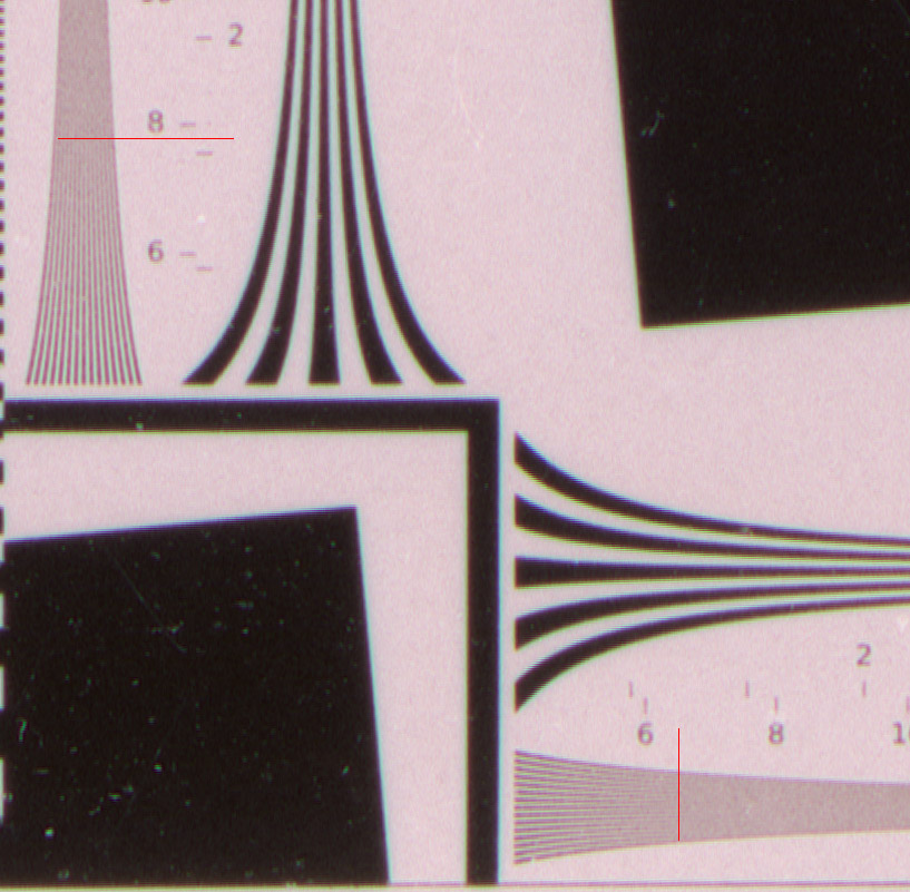

That's the result.
3650 ppi measured by Filmscanner Info because of factory-misplaced focus plane (you can see this is the reason, because the USAF chart shows the taletelling longitudinal chromatic aberration).

That's the result.

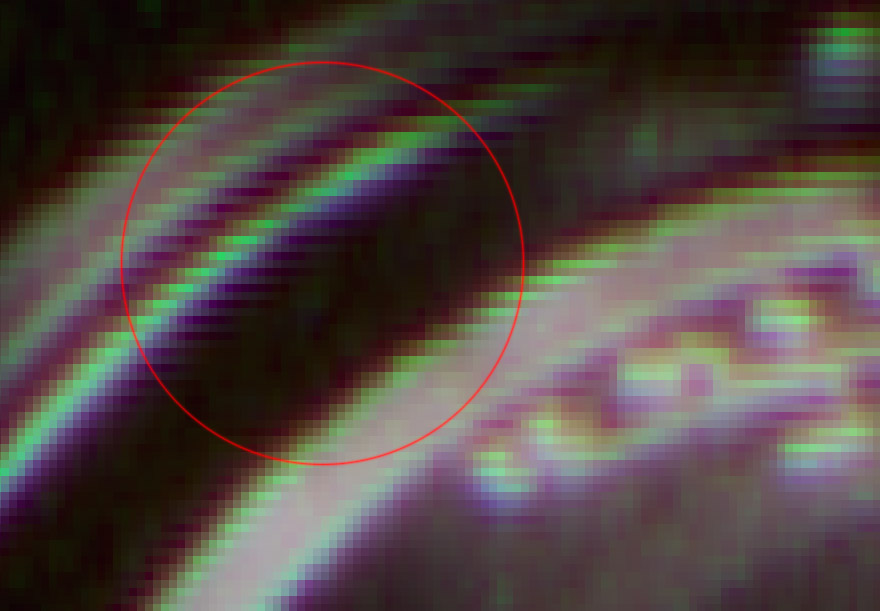

Just been reviewing a copy for the magazine I run (onlandscape.co.uk) and thought you'd be interested in a few images.
The film holders were crap so I jerry rigged two bits of AN glass from a slide holder and used them in the slide film holder. I used a Adox CMS20 shot of a resolution target using a Mamiya 7. About 240 lpmm should work up to 6500dpi (checked with a microscope).

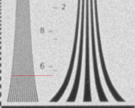

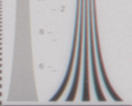

Firstly I compared the raw resolution with a Howtek 4500 drum scanner and an Epson V750..
Here's the OpticFilm dryscan (still in AN glass)
The resolution varies depending on direction. In the direction of scanning it's slightly lower at about 4500-4600 dpi. Across the direction of scan the resolution hit the 5300 figure (woot!) but I could only get that when scanning at 10600. Scanned at 5300 I got about 5000dpi.
Here's the Howtek scan. It got about 3900dpi and wasn't as smooth (this is just the green channel)
and finally the epson
Which is predictably awful - well it's OK for what it is..

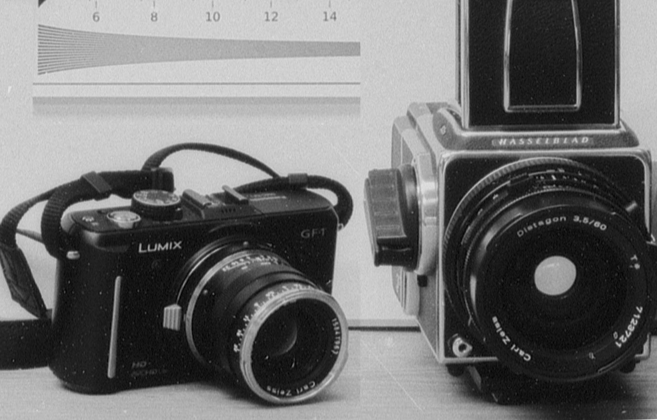

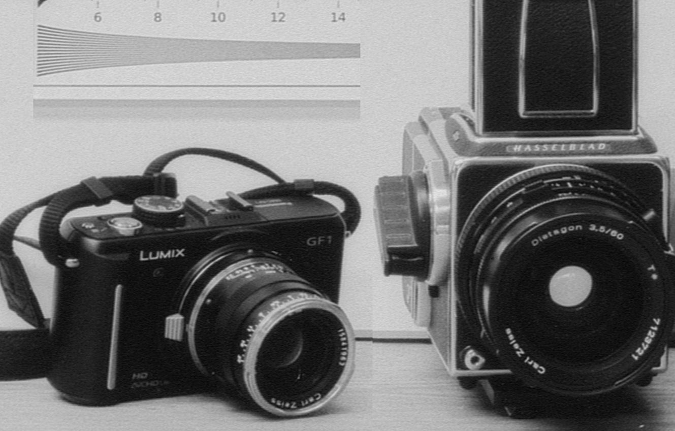

Scanning old negatives...
This one is from 1988 and from an old (1948) Rolleicord with a 3,5/75 Xenar with Ilford FP4.
While I recall that, I have no recollection of who the lady is - she must be 50 now.
And if you want, you can read the newspaper even today (a 5300 DPI scan):
The Silverfast software is a mess - but the scanner does nice things...
