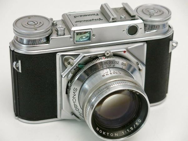

In 1950 the venerable German lens and camera maker Voigtländer of Braunschweig launched the Prominent, a beautifully made interchangeable lens rangefinder 35 with a large diameter Synchro-Compur 1-1/500 sec plus B leaf shutter located behind the 3-lobed bayonet mount instead of the focal-plane shutters typically used in its competitors. Designed as a high-grade, lower cost alternative to the Leica and Contax, it featured MX sync via a standard PC socket, a built-in self-timer, and the original model had a detachable accessory shoe. Although it was never a roaring success in the marketplace and was widely criticized for its idiosyncratic control placement, notably a left-handed 270-degree-turn focusing knob where the rewind knob is usually found, it sold well enough to soldier on with minor revisions (such as a two-stroke film advance lever in place of a knob) until 1958. At that point it was substantially upgraded to the Prominent II which added a high-magnification Albada viewfinder with stationary bright frame lines for 35, 50, 100, and 150mm lenses, a fixed accessory shoe, and a more compact film advance lever. Sadly, the Prominent II was phased out only 2 years later so it’s fairly uncommon, and a great user collectible.
Original Voigtländer Prominent with 50mm f/1.5 Nokton lens

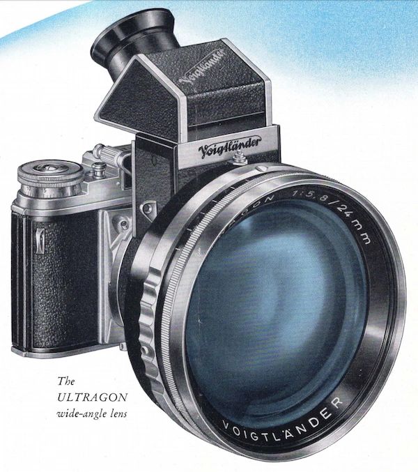

Prominent with massive 24mm f/5.8 Ultragon lens on reflex housing
Voigtländer Vaporware? Was Voigtländer's vaunted 24mm f/5.8 Ultragon merely an enticing prototype that was never actually offered for sale. At least one noted expert has privately floated this idea, so I checked it out. The elusive lens debuted at the first Photokina in 1950 and it was fully functional according to those who handled it. It was also featured prominently (pun intended) in the original Prominent manual, but it's not mentioned at all in the Prominent II manual of 1958, suggesting that it was either discontinued by then, or never put on the market. Bottom line: If any Prominent fancier out there has one of these beauties or has knowledge of its whereabouts, please reply to this post or send me a message.

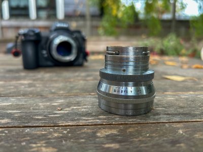

According to most reviewers and photojournalists at the time the Nokton’s performance wide open at f/1.5 was astonishing, and while I’ve never personally conducted a side-by-side comparison I did own a Prominent with a 50mmm f/1.5 Nokton back in the day and can attest to its impressive sharpness at f/1.5 and f/2 and its outstanding image quality, beautiful vintage rendition, and lovely bokeh. I regret that I never thought to adapt it to Leica mount to see how it compared to the original 50mm f/1.4 Leitz Summilux or the legendary 50mm f/1.4 Nikkor S.C in LTM mount, but I’m confident that the 50mm f/1.5 Nokton would have held its own even among such stellar competition.
Rear view of 50mm f/1.5 Voigtländer Nokton showing 3-claw Prominent bayonet mount

If you’re motivated to join the small but passionate group of original German-made 50mm f/1.5 Voigtländer aficionados, it’s pretty easy to acquire a functional Voigtländer Prominent with aforesaid lens at one of the vintage camera shops or online auction sites. Pristine examples with full return privileges aren’t exactly cheap at about $400-$750, and an LTM- or M-mount adapter will set you back an additional $200-$300. Of course, you may wish to consider a more convenient alternative—acquiring a brand new Voigtlander Nokton 50mm f/1.5 Vintage Line Aspherical II, a lens that delivers even greater sharpness, detail, and color fidelity while retaining much of the vintage character of the iconic original. It’s your choice entirely, and choosing both is definitely a valid option as well!
