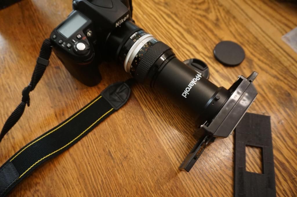

I hacked a 35mm film carrier from an old flatbed scanner. The carrier only contacts the sprocket holes and allows me to pull the film through one frame at a time. I tape this to my light box. It is, admittedly, inelegant though.
I usually rig up something very simple from a couple of Lego Technic pieces (some liftarms, axles, pins, and some elastic band) that I can clamp a neg between. Using Lego wheels laying flat makes that it doesn't shift/slide when I exchange negs. The DSLR is on a separate tripod.
