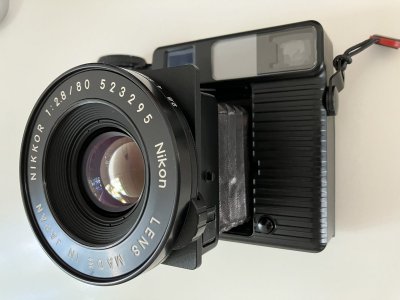

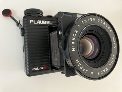

What about a picture of your acquisition? Of course in both meanings!

Finished a first roll today. I will report results once scanned. A picture of the camera itself tomorrow.

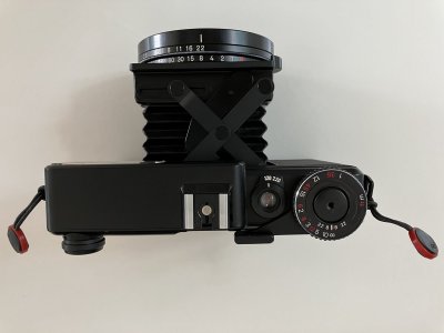

Thank you. The advice with a local camera repair shop is worth investigating. I guess even if I find one that has the test equipment, that leaves the question how you can advance the film counter to 1 so you cam fire the shutter - when the back door is open and no film inserted. I haven’t found that little lever or latch that will enable that.

I suspect it’s a combination of a little pin that checks whether a film is loaded and another pin checking that the back door is closed. Need to investigate that once again.

I have a Makina 67 and it's shutter can be fired without film in the camera, with back door open or closed, lens pulled out or collapsed.
I can’t figure out how I could fire the shutter without advancing the frame counter to 1 which in turn seems to require a film to be inserted.
I have identified two pins but even awkwardly pressing those and advancing the lever doesn’t move the frame counter.
