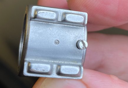

Hi, I don’t have a rangefinder camera (though I’d like one!) I do have a SBOOI finder with a problem, and RFF is apparently the place with most mentions of the SBOOI, so I thought I’d try my luck here.
The framelines on this SBOOI are quite tilted, so are no good for getting a level photo. I just got it from a guy on eBay, and by the angle of the protruding grub screw, it looks like the foot of the finder got a bit bent at some point:
I’m deciding what to do. The bent foot wasn’t mentioned on the eBay posting, so I suppose I could try sending it back as not fit for purpose (the seller doesn’t accept regular returns but I guess this counts as a defect).
But, I am also quite up for fixing it myself. And I’m wondering if anyone here has tips.
On this thread, the poster mentions straightening the horizon using the grub screw on the bottom:
However, loosening the big grub screw (the one visible above) doesn’t seem to loosen up the inner part of the finder within the containing cylinder. Should I try harder to loosen the inner lens assembly?
Or is the mentioned grub screw actually the smaller one of the two round things here? (Looks more like a rivet to me though!)

I just too a look at mine--no large grub screw at the end that yours has and it is marked 5 cm, not 50 mm, so I suspect that it is quite old. If it were me, I would send this one back to the seller since it is clearly defective. I can't imagine being able to level this by brute force and then you would have a finder that didn't really work along with a piece of Leica gear with virtually no value.

Thanks! Mine’s marked 5cm too, but I did see a photo of one with just the central rivet, like yours I guess. I read that the grub screw is actually to adjust the parallax a bit, that is to press against the hot shoe to angle the finder down a little? Anyway mine certainly doesn’t seem to do anything else than that.

I just took a close look at my finder which is marked 5cm. The very tiny thing in the middle has a slot so may be a grub screw that holds the alignment. Mine doesn’t have the larger screw and it’s possible that’s the one that needs to be loosened to rotate the optics on yours.

Your eyes are better than mine! I can only see the slot from a photo of this finder, not by directly looking.
Still, the front view shows that this finder is not just out of alignment but truly bent (looking at the lettering, which seems angled to the same degree). So even if I could adjust it, it is not as it is supposed to be. I’m starting to think that sending it back is the best option.

While OPs one does look seriously out of alignment (probably from a fall)
That said, on my undamaged SBOOI finders there is a slight angle to the frame lines as well, and while I know how to level them out, I think they were originally set that way on purpose. I once adjusted one to true level and all the horizons on my images were off when I used it. Weird.
Thanks, all! I hope this thread is a useful reference for others with SBOOI finders out of alignment. In particular, this reference is conclusive and helpful (if we’re talking about a SBOOI with the adjustment screw in good condition, which unfortunately mine isn’t):

I saw photos online of SBOOIs where the small grub screw had a good slot on it, and that would certainly work for adjusting. However, the one on mine barely has any slot left, and I think that it would be a case of drilling it out and then finding some other way to fix the optics in position. And that seems like too much effort to have to put in on a finder that cost me the market price for a proper working one anyway (around £120 plus postage).
If it had been much cheaper I would still take it to a jeweller and see if they could help drill out the screw. But for the price, I will just look to return it and get a refund.
