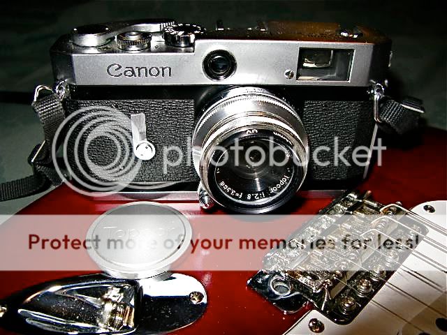

Hi all,
I am about to take delivery of a Canon VT rangefinder body with a chrome Topcor 3.5cm f2.8 lens attached. I cannot find much information about this lens so I am interested to learn about it (production year, rarity, etc). Any help you can offer is appreciated. Thanks.

All LTM lenses from Tokyo Kogaku are outstanding, and the 3.5 cm is no exception. They are all built very well, and they do not seem to suffer fogging, haze, helical binding, or other signs of aging as much as other brands. The 3.5 cm lens has 40.5 mm front threads, so you probably have filters and hoods that already fit. Tokyo Kogaku made a hood for this lens, but that is harder to find than the lens itself. Even harder to find than the hood is the 3.5 cm brightline finder -- it is an absolute monster (looks as large as the lens) with an outstanding life-size view.
It is interesting that Tokyo Kogaku had an inordinate fondness for 50 mm lenses in LTM. They probably made a dozen or more (I have at least 10 different ones), including one with a Heliar design. Most are labled "Tokyo Kogaku" and "Topcor," but earlier ones may have "Tokyo Optical" and "Simlar." Outside 50 mm, however, they only made 1 each at 3.5 cm, 9 cm, and 13.5 cm. The latter 3 are hard to find, but at least you got the first one.

First post on this forum. I recently acquired one of these (3.5cm f2.8 LTM) lenses very cheaply. Been loving using it but did anyone notice heavy edge to edge fall off even @ F11?
Thanks
Welcome to the forum. I have a Tanack Tanar 3.5cm F3.5 from about the same era, and it also vignettes - not sure if it persists to f/11 though. The Canon 28mm F2.8 in LTM does the same. As I recall, vignetting is pretty apparent in the early Leica 21mm Super Angulon as well. Wide angle lens designs like this were rather challenging engineering efforts for the 1950's. Optimizing aberration correction, together with distortion and vignetting, was challenging in the era before more sophisticated computer techniques were available, so some design tradeoffs were necessitated.
However, all said, I like this effect in many pictures. It gives certain shots, particularly landscapes, sort of an "aura" that is pleasing.
If you can, please post some photos of your lens and/or photos taken with it. Your lens is very uncommon, and maybe even rare!
