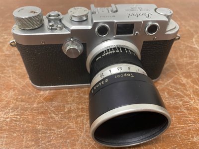

One currently on eBay. Not in great shape, has haze
She also has another in much nicer condition, for all of $649... The example I bought for my G came straight for Japan, quite Mint-, but not quite that $$$.

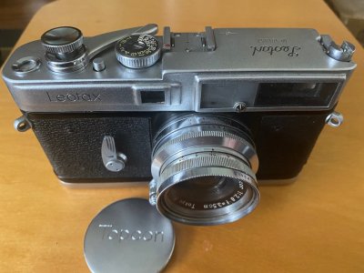

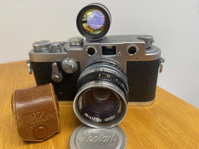

Three of my favorites.... Leotax G w/3.5CM/2.8, Leotax FV w/5CM/2.0 Panda, and Leotax T2 w/5CM/2.8 Topcors. The picture of the G was before
I found the correct lens generally sold with it, the 5CM/1.8 Tpocor. The Panda is very hard to find in good condition...if at all. This lens was purchased from Japan and was quite costly.
