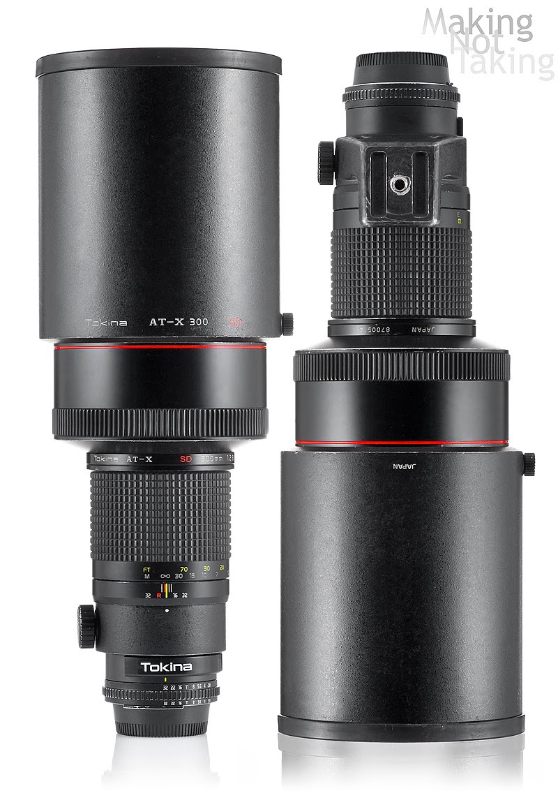

That is one big tripod Nokton48! Your lens is only 1.4Kg, it looks fairly small and the weight looks divided along the length of the lens, while my tokina 300mm 2.8 weight 2.8Kg, and the heavier part of the lens is the front with a big low dispersion element, that's a big piece of glass that front lens alone (112mm diameter):
One of the beauty of this lens is the internal focusing, making it extremely easy to manual focus, unlike any other tele I have used (manual focus legacy teles mostly) All it needs is a third of a turn to focus from 2.4m to infinity with barely one finger.

Here is my lens, it looks like this one:
