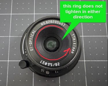

has anyone else experienced this:
i've been contact with TT Artisans about this but they don't seem all that interested in helping me get this taken care of.
considering the relatively low cost of this lens in the first place, the cost of a round-trip to China + whatever they may charge to make a repair, may not be worth it.
any ideas?

i think the hood caused the problem. i tend to carry my camera rather haphazedly over my shoulder and no telling how many times the hood was knocked.
there is nothing loose that i can see.
maybe if the indicated cosmetic ring could be removed there would be something to tighten underneath. that seems like it would fix the problem if there was.
i not ready yet to go after this ring to see if it pops off or unscrews. at the moment, i don't have the proper tools either way.

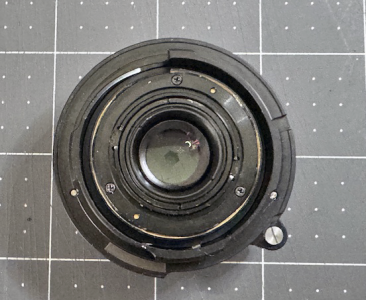

look at the lens from the back
thankfully they are painting the rear flat black now unlike the one I had
take the front and move - wobble it looking at the back to see if anything is loose
there is an outer spanner ring with 2 holes & 3 screws probably can't tighten it
perhaps the next ring in ?
I really don't know but many lenses the optical group you can separate from the focus mount
thanks again for the feedback but nothing moves at all on the rear of the lens
the problem is isolated to the front part of the lens from the aperture ring forward. it is loose in both places indicated by the arrows. that is on both sides of the aperture ring. everything else, including the focus ring, is secure
my guess
the outer ring with 2 holes & 3 screws unlikely to help - don't do it
around the glass the next ring in has very wide slots still unlikely
next ring may be it - but once again a guess - I guess

i concerned that the lens is about to fall apart. it was not always like this and it is getting worse. this is a far worse condition than "play."

If this lens is indeed a close copy of a Leica design, that large black ring should unscrew just like on the classic Summicron v1/v2, where it secures the name ring/aperture ring assembly.
Try using a rubber plug to see if it turns counterclockwise. If it comes off easily, any play or looseness you’re feeling is likely caused by loose screws or spacing washers under it.
The inside black ring with slots is the front lens group.
The inside black ring with slots is the front lens group, without unscrew the large black ring on top of it, it will not budge on either directions.
that is my next move. i've ordered a set of these rubber plug things from Amazon and will see what happens. i feel pretty sure that if the lens is going to self-repairable (and not require a replacement part of some kind) the solution will be revealed under that ring
it is concerning that a concentric ring deeper, closer to the glass, turns easily in either direction and does not appear to tighten. that could be B-A-D. 🙂
