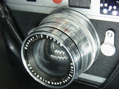

I picked up a 1958 Zorki 3C with a perfect-glass J-8 this month- with the intent to clean and shim the lens for Leica mount. Gave the focus mount the full works, including using fiber-optic polishing sheets for the finish and metal-to-metal movements. Came out really smooth. The Tabbed J-8 mounts with the three screws for the retaining ring holding the mount in are the easiest to work on, and come out the smoothest for operation. The tolerances are tighter than the 1960s lenses for RF vs actual Distance.
Got the lens shimmed for close-up, but would not focus past 10m. Th focal length was much longer than most, could not use on a Leica. SO- yesterday I used the J-8 mount for a Sonnar conversion. A very clean glass 5cm F2. Came out beautifully. Some pre-war Sonnars require you swap out the Aperture ring when screwing into a J-8 focus mount. This one did not. Once shimmed, re-indexing was simple: take out the longer set screws and use shorter ones. No need for Taps, the screws hold the mechanism against the underlying threads for the aperture ring.

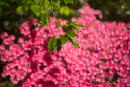

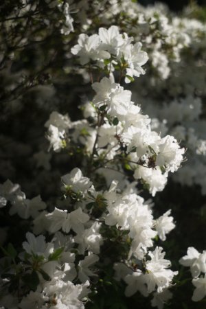

Really good color saturation for an old uncoated lens. You chose wellWide-Open at F2.

The 1958 J-8- I mounted in a 1951 Focus mount sent for spare parts, that I used for practice. Re-assembled, found enough set screws to complete it.

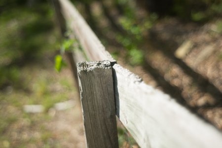

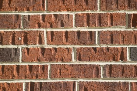

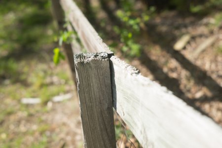

Bright, Sunny Day. I took this lens out for a second test- this time on the Leica M240. The focus via RF agrees perfectly with the EVF. I used the M8 to test the focus when shimming this lens. I have the M8 and M240 "Tuned" to my M9, which has been used to shim lenses for many Leicas.
"Stupid Brick Wall test" at F2 and F4,
Followed by the slat Test, F2 and F4.
And of course the Fence Post,
F2 and F4
F2 and F4
