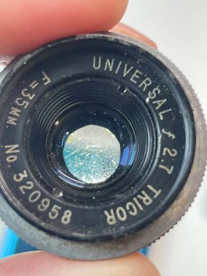

Hi everyone, I bought two Mercury IIs, one with a lens and one without...not knowing what to expect I just hope for the best...when arrived, both shutters were frozen but with some WD40 sprayed into the mechanism and repeated firing, both shutters came back to life...seems to be in a good working state now...BUT after testing the units with film, another weird problem surfaced...the pictures are all strangely out of focus, and it is the kind of blur that occur when flange focal is off...since I used very small aperture and tried many different focal distance, the negatives all came out blurry...and this happened on BOTH cameras. I am now suspecting that maybe it's the lens? (since I only have one lens, and it's been used to test both cameras)....does anyone have some idea what can I do next to test further? Should I take the lens apart and see if the glass elements have been flipped or something (saw that in a post somewhere as a possible issue)...thanks
WD-40 should be avoided, leaves too much residue and goes everywhere. Best to use Lighter Fluid sparsely on the shutter blades, or Isopropyl alcohol 99%.
Post some pictures of the lens with a light shining through the back. Do you have the experience and tools to take it apart?

Here are the pics of the lens, I had a lens spanner before and I did have some experience with taking a lens apart, but I need to get a new spanner since I don't own one anymore now.
