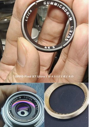

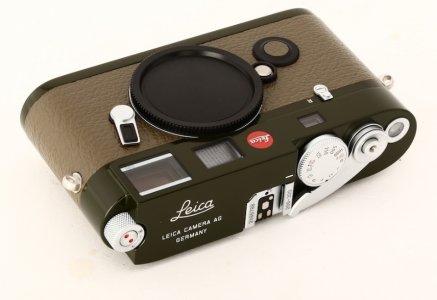

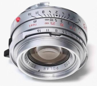

Argh, the relica MP parts aren’t difficult to source… in the places so many replicas going around, and they are very well made. I am not claiming that whatever the original post MP is not authentic—just that the paint looks different.IMG_2834.jpegIMG_2833.jpeg

In the Mr. Z’s place, CNC is just like BBQ oven in USA, every family have one….. make a part as easy as buy a beer in a gas station
