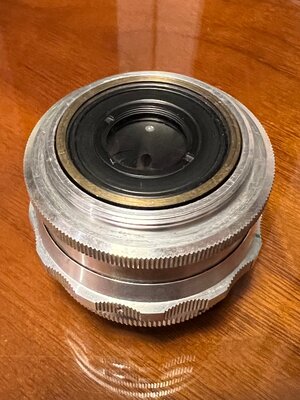

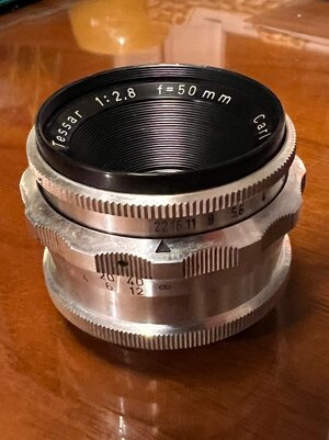

Thanks, here are the photos.
Does it mean that the Contax version converted to LTM will not work with Bessa?

Wow, is that lens really from 1935 and was it really "converted" with a proper focusing cam to M39? That lens normally comes in M42, or it might be using the Soviet M39 standard that it used for its own SLRs from the 1950s. I could be wrong.
Anyway it seems it will not work and this can be expected.

It is in an M39 Paxette mount lens (not compatible with L39 mount).
